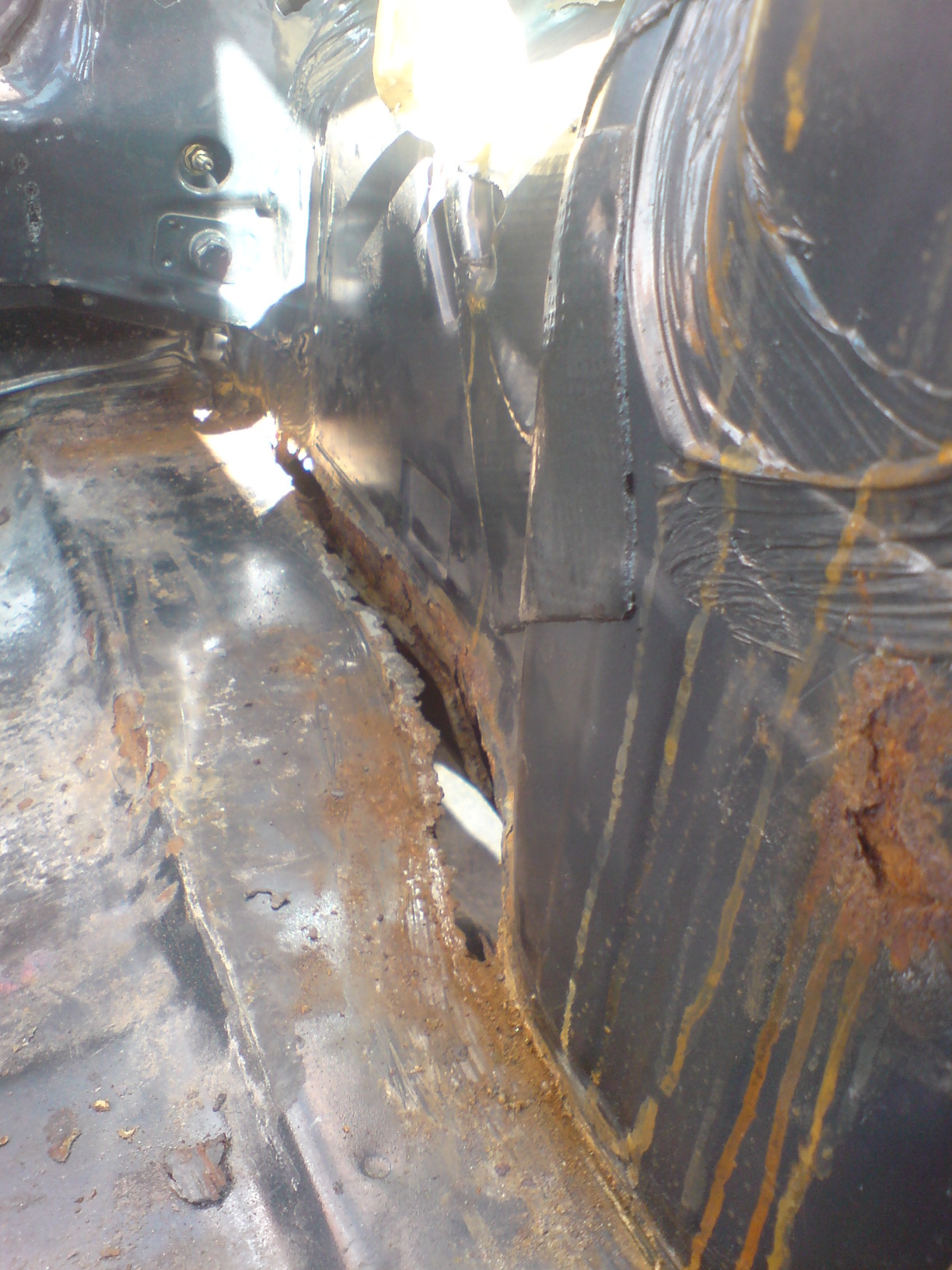

a quick look around the boot with the help of a mallet revealed three bad corroded areas, shocker top mounting area, and both corners of the boot floor.
after being a member on here a while, i really wasnt suprised by this.
<sigh> :(
Yet another case of a clean car rusting from the inside out.

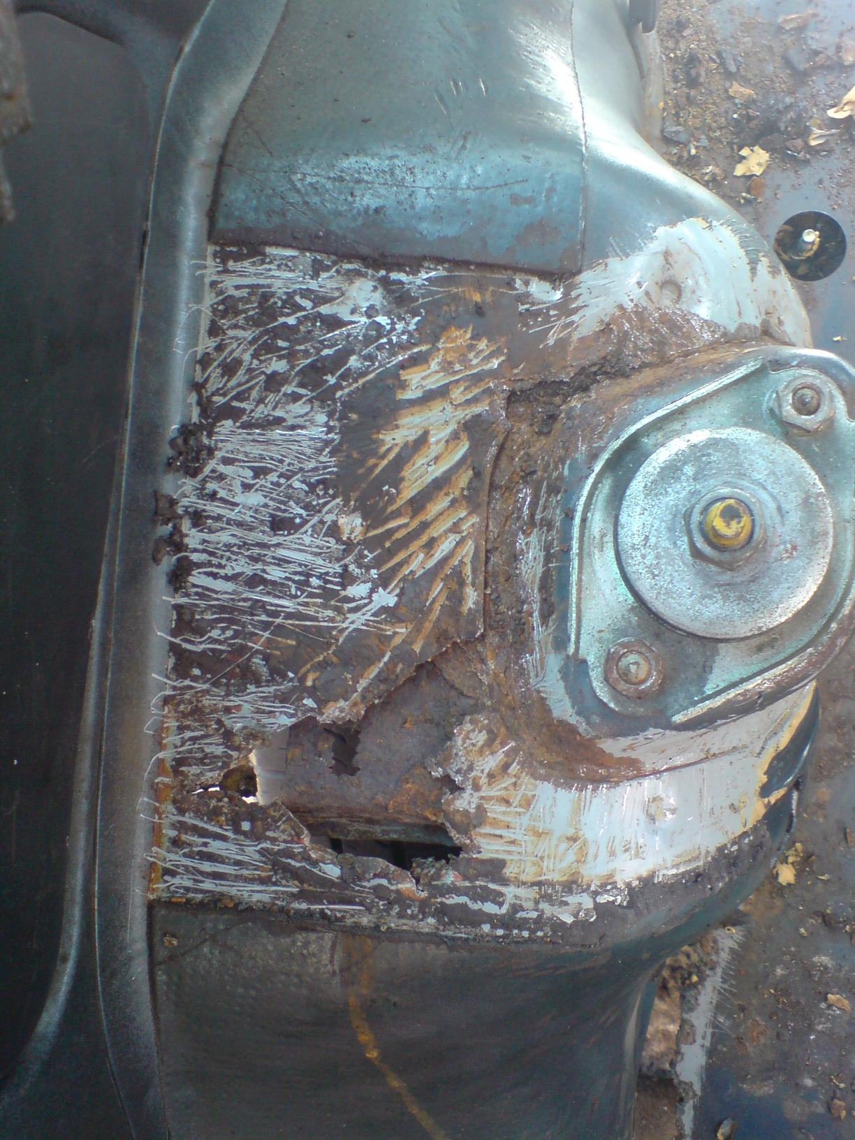

had a hard job welding the plated area around the shocker top, seen as theres a huge difference in thickness of both the plates- welder to high, penetrated the shocker top mounting area but melted sheet metal. welder not turned up enough- wouldnt penetrate into the shocker top mounting area:bang:.
i had to run i line of weld around the edge of the plate, then weld the line of welds to the shocker top mount.
not quite happy with the finish so will grind back the welds, and possibly reweld just for neatness. either way its solid:slayer:
