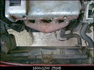

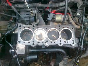

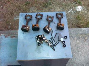

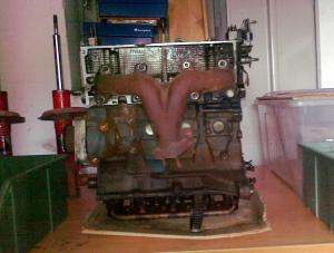

test bench engine (for keep car still running)

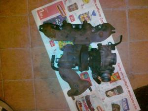

nice gift
scrappy car

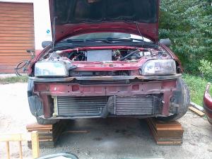

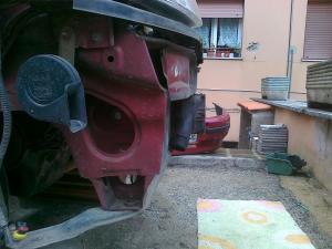

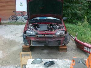

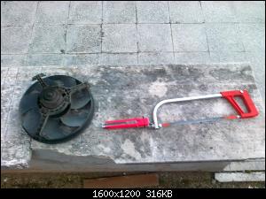

First moves:

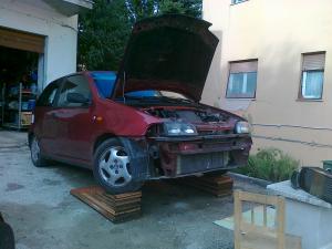

Love the space:
Hope to not taking years for seeing it finished
