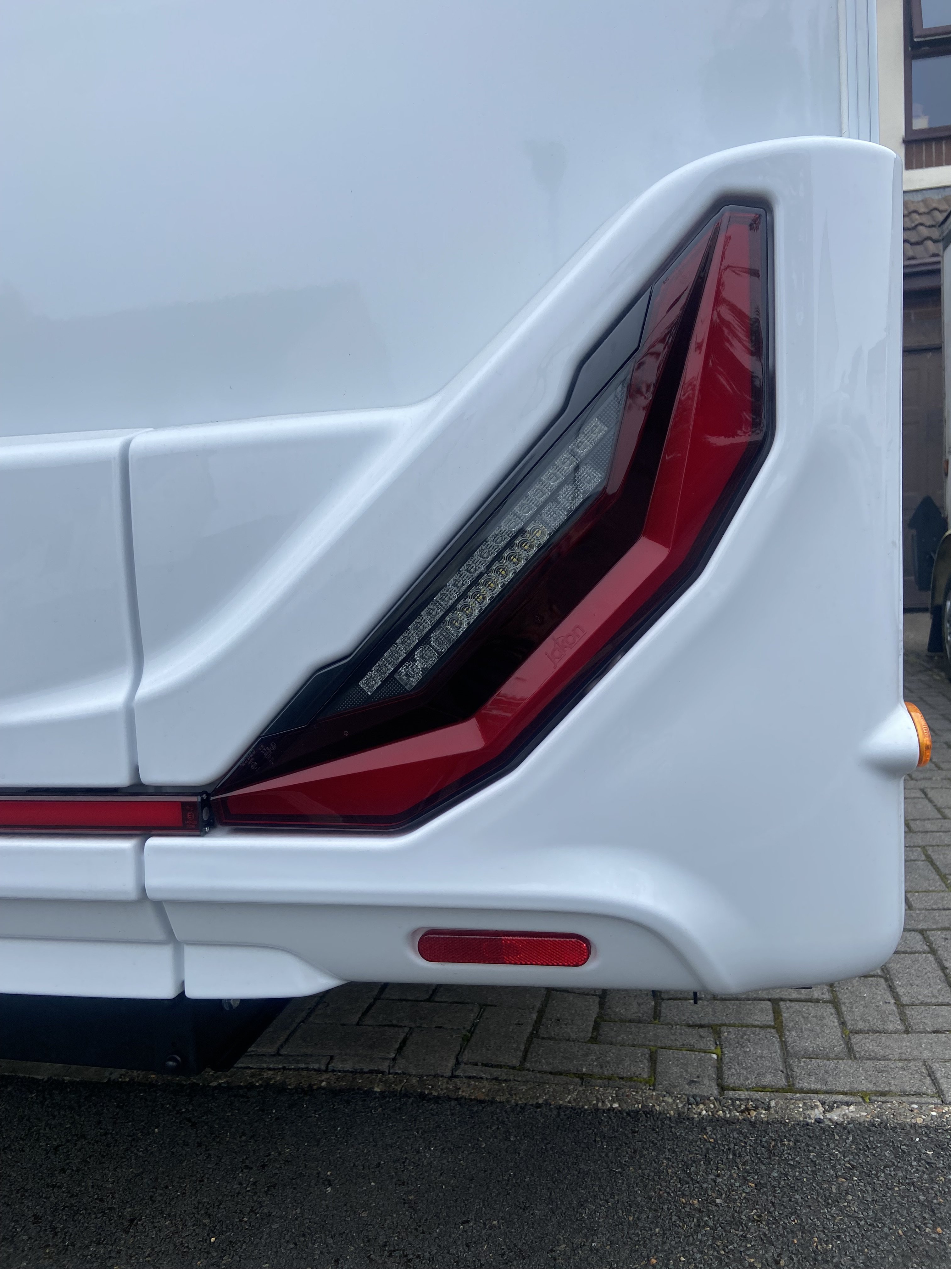

Good afternoon
I have just collected my new motorhome a sunlight a68 on a Ducato 2024 2.2ltr and want to fit a Bluetooth reverse camera which I have fitted to my previous motorhome and was very pleased with , my question is has anyone had anything to do with a Jokon rear light cluster as pictured as I’m sure there is an easy way to remove it to access the reverse light live wire but with no visible fixings I don’t want to break anything trying to click it out
Thanks in advance

Why don't you contact Jokon on their website and enquire how the lense is removed.
Yeah I am going to do that but thought I would ask on here first as someone can normally answer the questions asked

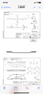

Hi
Yes I did find out and got the job done thanks to Jokon lights in Germany (unfortunately Jokon UK were not very helpful) please see working drawings on attach it is a bit tricky and the clips are tight so take your time , if you can’t work out the drawings contact me again and I will take some photos of how to remove
Thanks for your quick reply, i have tried to work it out from the drawings but i am struggling, some photos would help me if you dont mind
Hi
You need a tool something similar to the photo , after checking the drawings I sent before for the exact clip location push the tool between the light and the bumper trim turn downward and pull lightly you will feel where the clips are by the resistance then pull once the dark trim is removed there are screws to remove then pull the light cluster out at the top then upwards to remove I hope this helps , please take your time as these parts would be easily broken good luck
