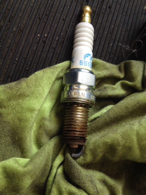

Here are the spark plugs after 15000 km ImageUploadedByFIAT Forum1378204599.546812.jpg
Plug looks good. Nice colour, no debris.

The plugs do indeed show the engine to be in good condition but the plugs themselves look shot. Those photos don't show the important detail of the shape of the central electrode but you can clearly see a yellow ring around the base of the ceramic.
Good flame propogation needs a sharp edges and unfortunately the central electrode on copper cored plugs rounds off quite quickly due to spark erosion. The performance of Cu plugs degrades significantly after about 10,000 miles - you will usually notice a difference in the way the car drives if you replace the plugs at this point. Ir electrodes are much more durable and maintain a sharp discharge point for many thousands more miles.

I wonder if the TA uses iridium plugs as standard?
Hmm, I'll have to look at my service records, I can't recall ever seeing spark plugs mentioned.
As an aside, the US Fiat 500 Forum has some interesting FAQ's, such as...
What spark plugs are used in the Fiat 500?
The spark plug used in Europe for the 1.4 liter 16V version of the Fiat 500, NGK’s DCPR7E-N-10 are fitted as Original Equipment. This 12mm spark plug has been developed specifically for the Fiat FIRE MPI engine family. It is a nickel alloy plug.
This small diameter spark plug lends itself well to the compact combustion chamber of the multi-valve 1.4 liter engine.
... I take it that they are standard, not iridium plugs?

Standard ones are copper, not iridium sadly.
