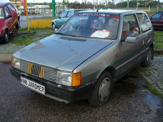

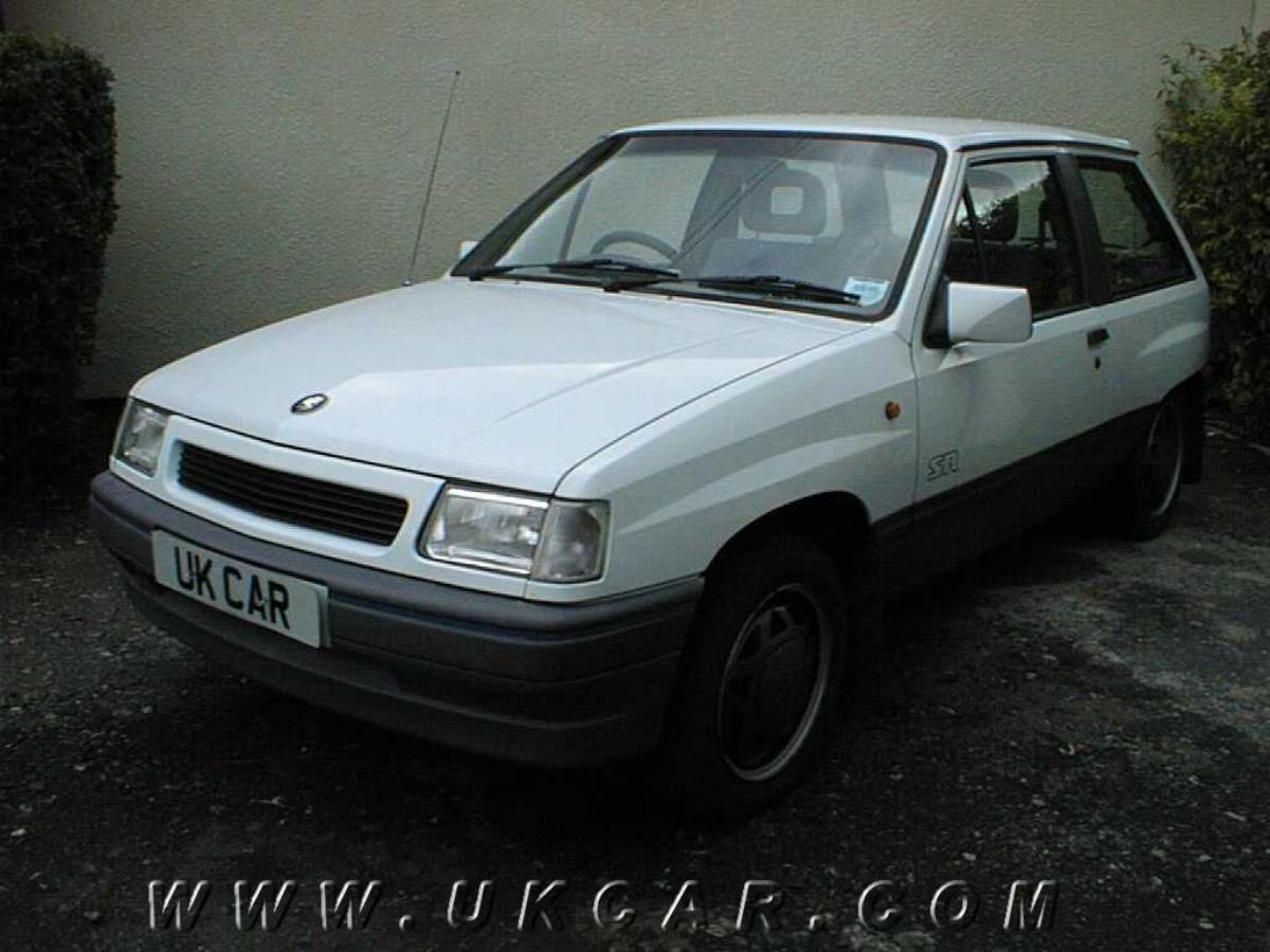

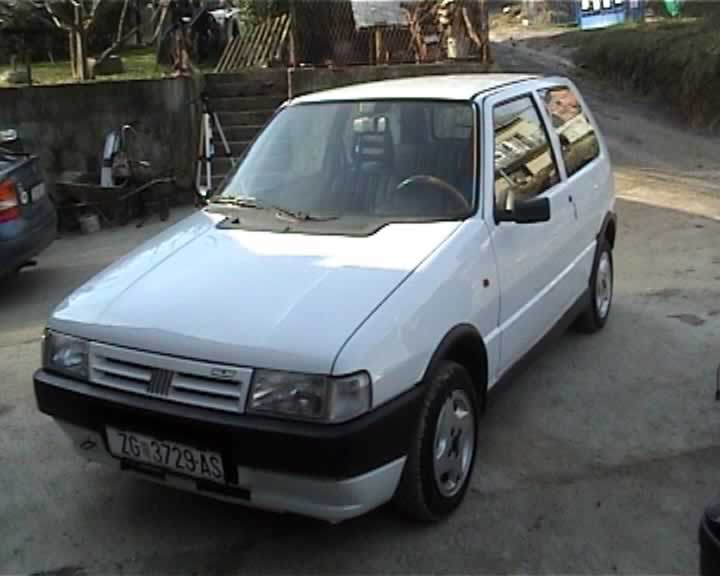

Yes indeed. The problem is that the Mk2 nose is not much of a job because it's smoke-and-mirrors, the bonnet is at the same height so it's rounded off at the front edge only, and the front bumper is raised. Therefore when you put the Mk2 and the Mk1 side-by-side, the Mk2 isn't any lower or sleeker and neither car looks 'modern', so you might as well have the original. It's a bit like how Mini enthusiasts view the Clubman, except that had some advantages in engine bay access etc. which the Uno Mk2 doesn't.
Same goes for the interior - the Mk2 looks pretty average and not 'new' (being made of hard, uniform plastic materials), while the Mk1 looks quirky and actually works well, the strange-looking controls are robust and easy to use, and light up at night :) The seats and headlining of the Mk1 do fall apart, but you can probably devise a clever re-trim somehow, so I would not consider that a reason to reject a particular car (instead, more of an opportunity for personalisation).

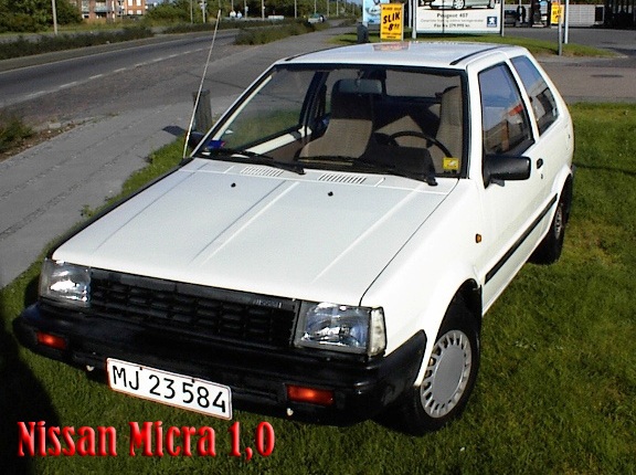

Somebody told me that the Uno Mk1 looks like a Nissan Micra, but I think that's ridiculous, like saying that a Ferrari looks like a Lamborghini. I used to think that the Uno Mk2 looks like a Vauxhall Nova if you hollow-out the radiator grille, however, I now realise that this association was just as stupid: see photos below ;)
I tried hard to find some similar photos for comparison, and I've uploaded the four best choices (pity that the Uno Mk1 was in rough condition, but you get the idea - look how curved the bonnet is on the Mk1 compared with the Nissan!) In both cases I think it's clear that the Uno has the cleaner, less-cluttered styling. You can also see how the 'nose job' makes little difference. And as for the bonnet height, compare with the Grande Punto (which of course I have also found a photo of, for your convenience...)
