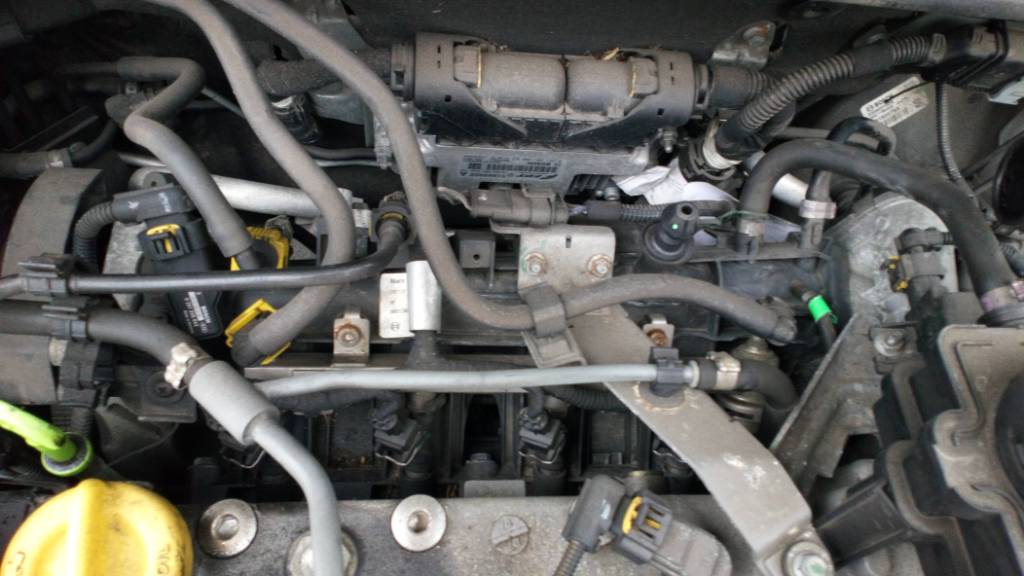

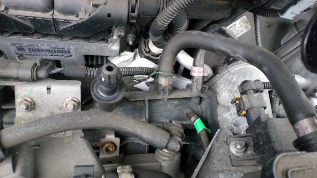

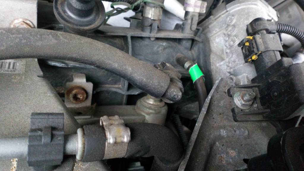

Hi I'm pretty sure it is the vacuum line but not 100% I've put a green sticker round the pipe in the pictures thanks for any reply and help DSC_0059.jpegDSC_0060.jpegDSC_0061.jpeg
That is indeed A boost/vacuum line.
BUT don't use that one, it's used for the fuel pressure regulator... .. the short of it.. you risk blowing up your engine if the fuel pressure regulator doesn't see the correct boost/vacuum.
Thanks I'll have a look at ting on the pipe you outlined I don't want to drill my manifold just in case thanks again
