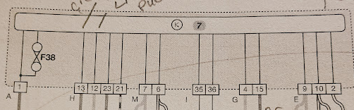

I've got this little oddity where F38 should be -the hopeful thing is that it's a 20A fuse, as it would be for remote locking.
Also, that plug next to it looks like it's got grey and yellow wires, and they're the ones I'd need for the doors according to Haynes anyway. (They may of course be two colours with the stripes hidden to confound things).
F38 should be a 20A it should be the relay in the body computer that powers all the door motors
The motors do not just go into one connector the in M, E and H
Fiat often share fuses, you will have to pull F38 and make sure there's no adverse effects
I've added the picture that I forgot from the post above.
I really appreciate your knowledge here - but does it stretch to where I might find pinouts for the body unit? Haynes gives me these from 1-36.
Also M, E and H, wossat?!

Lightbulb moment. The Haynes diagram above labels A, H, M, I, G and E in the image above. As you say, all over the place.
