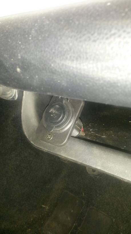

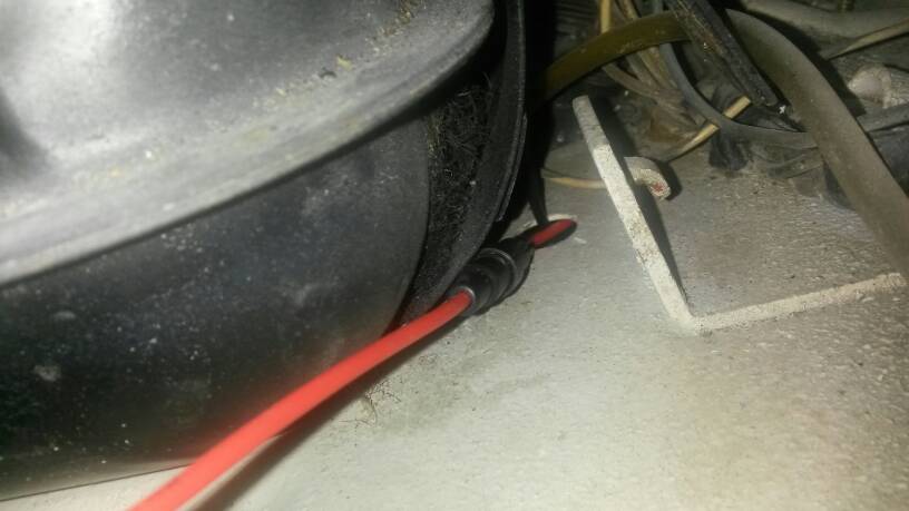

Ok a few pictures....but please no comments on the quality of the wiring [emoji15] as it does all seem to be working [emoji3]. I haven't shown the actual connection to the fusebox as it is exactly as Peter's photo. The earth is the black wire with a ring connector on the fuel tank (not the iffy looking red wire). Hope these all make sense!

While I know and appreciate these add ons are fuse protected I would urge that the wires are run through grommets where they pass through panel work. Our cars aren't the smoothest on the road which can cause a lot of things, wires included, to jiggle about and this could abrade their insulation and cause a spark which, being close to the petrol tank could be really dangerous. Grommets are so cheap and easy to use, please don't take chances (y):D
....with apologies for the layout/post...did it quickly from my phone and I'm not technically gifted!
Thank you Andrew. Really appreciate you taking the time. Just a quick question, the red wire seems to have a black connector on it, is that a fuse or something?
Yes I agree that putting a grommet is important and will do when it comes time to install mine.
Thank you all for the help (y)
Yes. The black "connector" is an inline fuse. Good luck.
Thanks Ian. As a newbie to all this it is always helpful to get hints and tips especially if safety related. Will get some grommets tomorrow (now wondering if any wires through the bulkhead have them :-( )

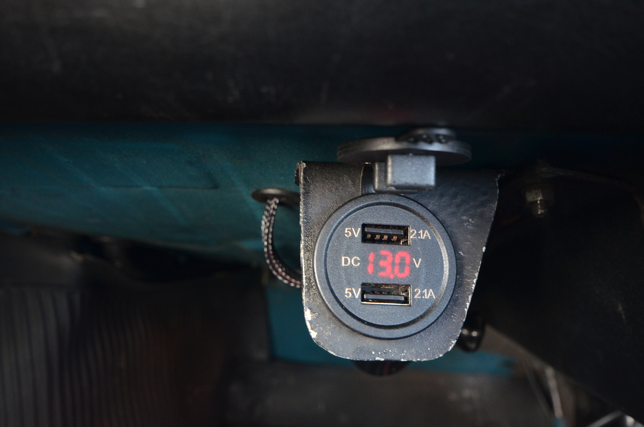

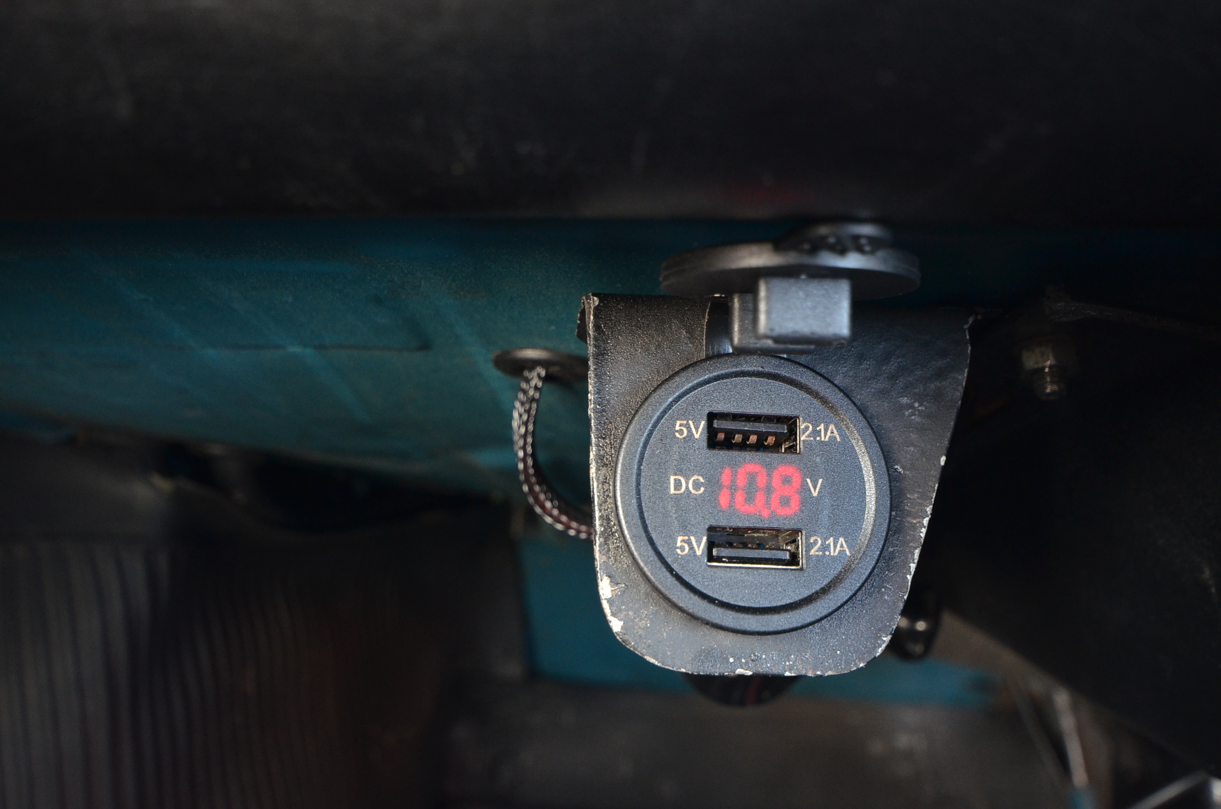

I was getting a bit annoyed about the cigarette-lighter socket I fitted ages ago. The separate adaptor for USB was never a good fit and used to fall out and leave my phone uncharged. So when I had to move around the wiring and bracket recently I went for a dedicated USB socket similar to the one shown at the beginning of this thread. It fits in exactly the same hole as the lighter-socket but has a more positive locknut at the back to keep it secured. An added bonus is that it has a built-in voltmeter. This serves no real purpose but it's vaguely interesting to see the voltage go up and down. Ahhhh
