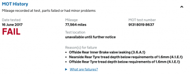

I needed a car for work, and a friend has offered me a Fiat Punto. It's broken and off the road, but if I can get it going, it's mine for free. I've checked the MOT failure, and it failed on tyres, and the offside rear inner brake.

Tyres... self explanatory, Inner brake???? WTF is that? Strip down both back hubs and see what you have,
04 Active sport has standard rear Drum brakes, 2 types available ABS and Non ABS. Make sure you get the right ones. Non ABS shoes cost slightly more than the ABS ones but the 2 are not interchangeable, if its the same as my 04 Active sport then most likely NON ABS.
Reason for this is NON ABS ones come with the self adjustor mechanism on, ABS ones come without..

When you say "It's Broken and off the road" what else is wrong apart from the rear brakes and Tyres ?
I susoect the rear wheel cylinders bleed valve has rotted out....
This happened to me not to long ago
Got a brake fluid leak, and also failed mit
Similiar age too...
The fix isnt too bad, as it strip both units out and refit and bleed
The drums will want a clean and readjust and youll be good to go

It's the brakes that I'm not sure how to go about. Working in a breaker yard taught me how to tear cars apart, not put them back together, so putting on new brakes is new to me. I don't have a photo of it, but when we looked at that brake before I knew it was the problem, I knew it was bad, so I suspect the whole thing needs to be replaced. The pads should be okay though.
What's the best way to go about finding exactly which part it is? And,
