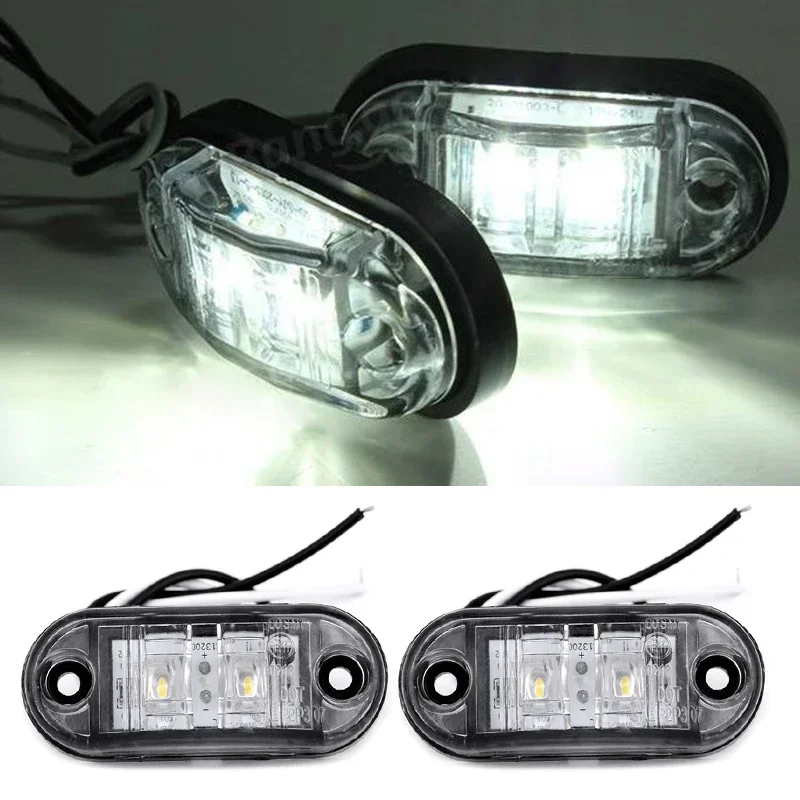

Like you I found the panda very dark at the back, so added 2 shoulder lights and lighting for the footwells. All are led so draw less than the original filament lamp.
I created a loom for the floor light fed from the front centre light and routed down the left screen pillar and along the centre console.
The loom for the roof has to avoid the airbags so goes across the middle. All wires wrapped in anti-rattle flame retardent tapes as the manufactures use.
It makes a big difference to the light level in the back seat area.
Cool! You make it sound easy, but running wires invisibly +safely around the inside of a car (never mind affixing the light fittings neatly +securely) is not a simple job - I’d end up totally trashing the interior 🤣

It’s a really nice job. I may have a go at something similar when I get a bit of spare time.
I'm also interested in doing something similar. Where did you obtain the anti-rattle fire-retardant tape please? Does it go under a name?
