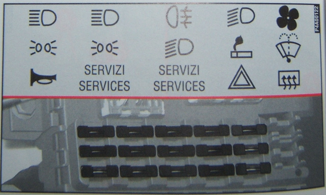

For the courtesy light fuse its shared with the radio, glove box light, boot light, RCL reciever, alarm power supply. and it says clock power supply too.
It is behand the panel on the dashboard where the drivers right knee is, it should be 10 amp and one of the two servizi Services. Shown here
heres another pic to show where it is;
