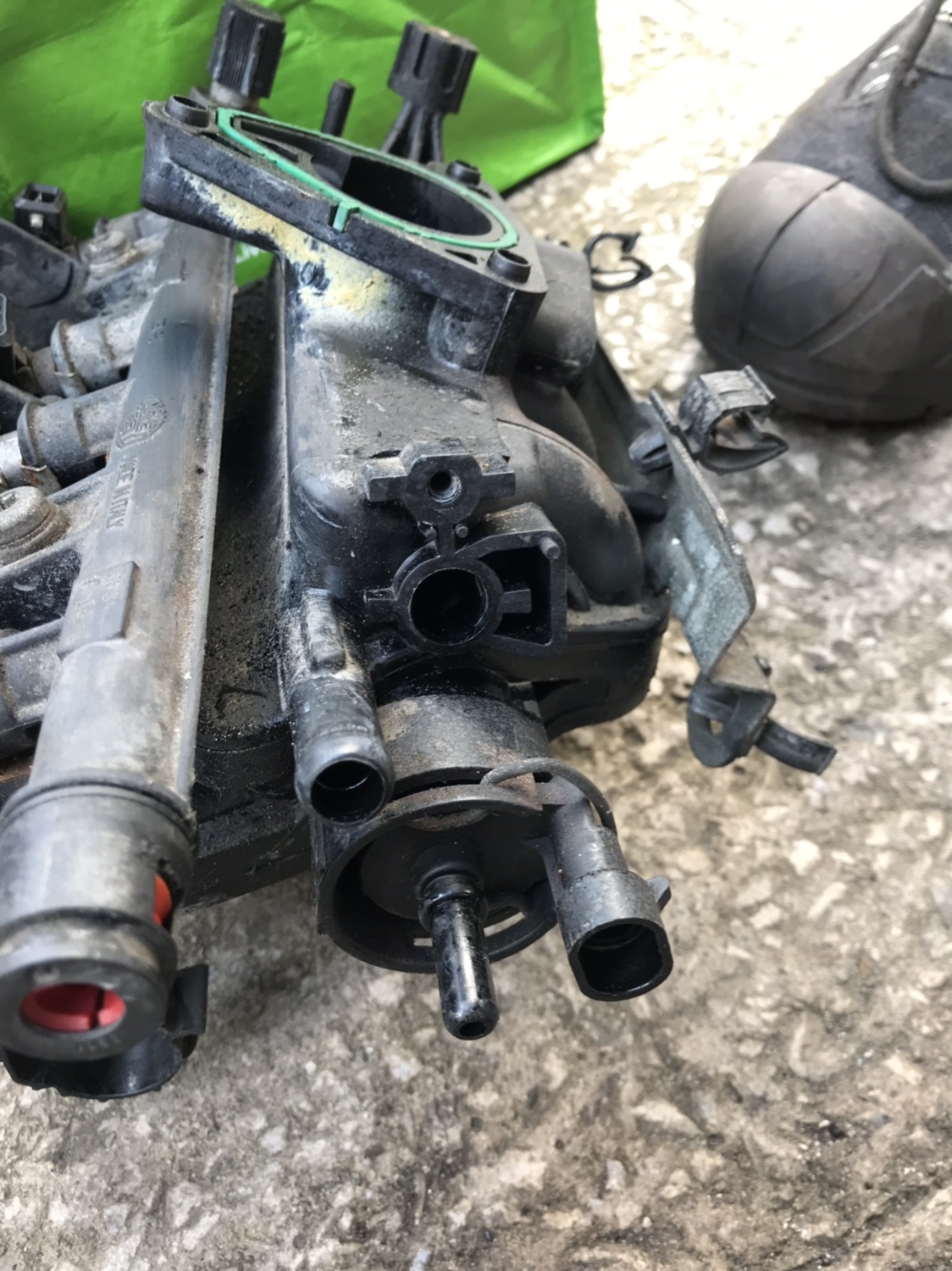

Hello I would be grateful for someone’s help. I have a 2004 5 door mk2b facelift 1.2 8v Punto. My mechanic is replacing my inlet manifold so I have bought a used one from a breakers with injectors attached. It says it’s compatible but when the mechanic came to attach the MAP sensor the socket on my replacement is different. The map sensor interface should look like the photo from my current inlet manifold IMG_1973.JPG
Does anyone know if there is a difference between mk2 and mk2b inlet manifolds ?
Thanks in advance [emoji4]
The later MK2B's have the same engine as the early Grande Puntos. Does your car have the round screw off oil cap or the squarish pull off oil cap? The round one means you have a GP engine. Squarish one means same as MK2.
