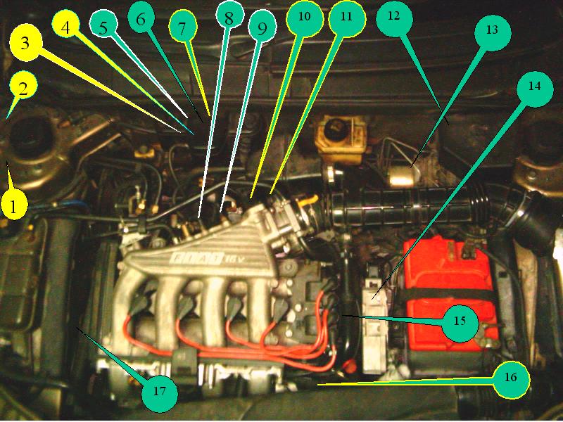

could anyone advise me on were i can locate the iat(intake air temp sensor)or engine temperature sensor and does anyone have any idea were i could locate a workshop manual for the 1.6 sx as haynes could never be bothered to print one well thats what their website claims anyway...thanks in advance :)

or see photo attached
1. Fuel cut off solenoid valve (underneath)
2. Carbon Filter (underneath)
3. Lambda sensor harness (in the black plastic cover)
4. Manifold Absolute pressure sensor (MAP) (in the black
plastic cover)
5. 5A fuse for injection-ignition system (in the black plastic cover)
6. 20A fuse protecting components supply by the dual relay
(electric pump, lambda probe, injectors & fuel vapour solenoid
7. Dual relay (in the black plastic cover)
8. Hose for Fuel pressure regulator
9. Air Temperature sensor
10. Stepper Motor a.k.a engine idle speed actuator
11. Throttle position sensor
12. General 30A system fuse
13. ABS - electro-hydraulic control unit
14. Injection- ignition ECU
15. Coolant Temperature Sensor (below the ignition coil)
16. Fuel pressure regulator (under the cover)
17. Timing sensor (at camshaft intake sprocket) & TDC sensor (bottom near main pulley)
