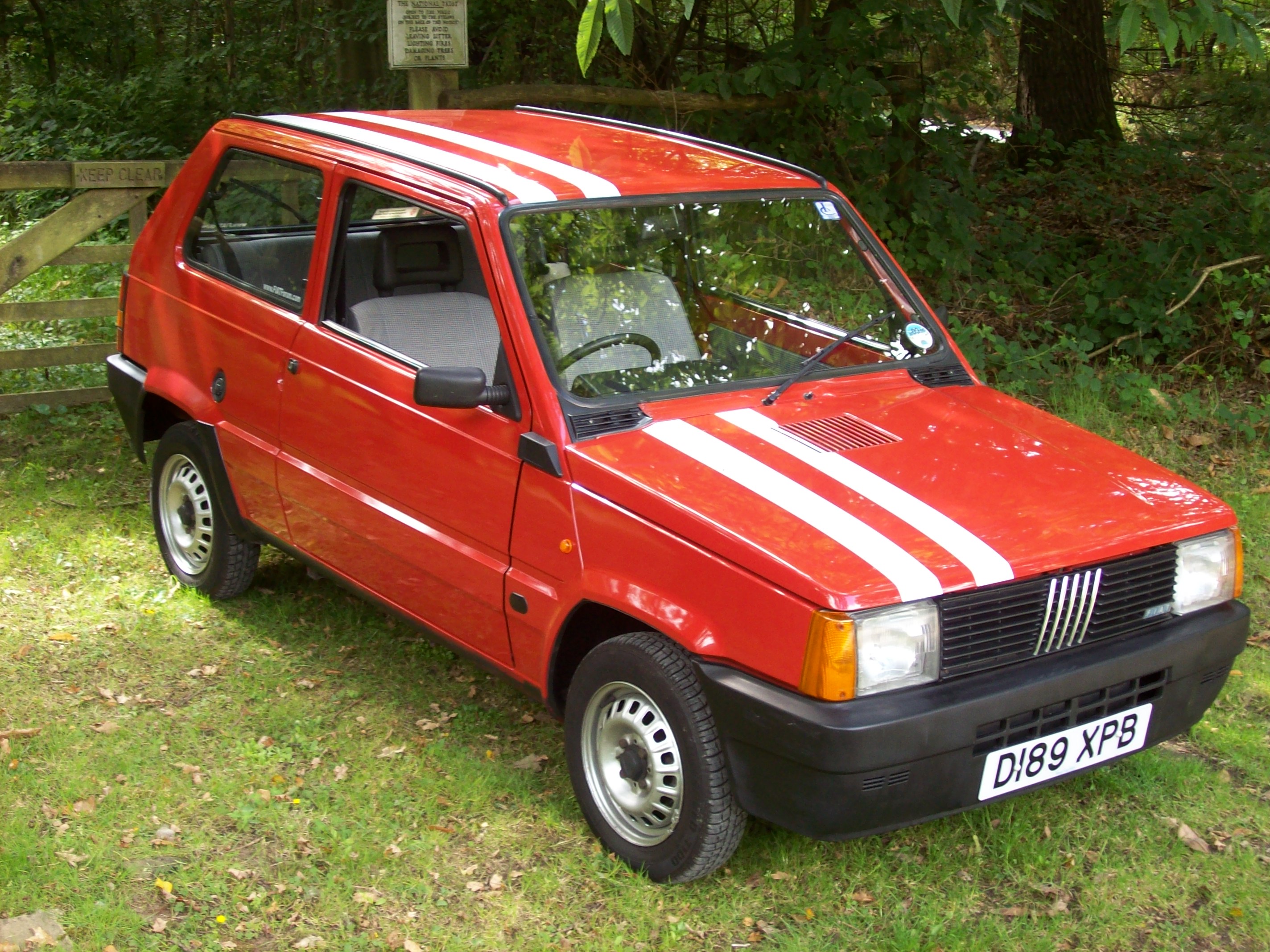

Hello, this is my first post so hello, great forum by the way. Anyway, down to business, i've just bought a j reg 750 Panda, perfect body work and pretty good all round apart from a couple of little problems.
First off, i cant turn the heater of and its driving me nuts. I just fitted a new stereo and the previous owner had done mad things to the wiring such as disconnect the clock and cigar lighter and ram the cables under the instrument panel, anyway whilst fixing the wiring i found that the dash housing is totally screwed( bizarrely some of the screw fixings seem to have been melted). i say this because i suspect you might tell me that i need to get to the temperature switch and i dont think the dash will go back on a second time.
if anyone has any idea whats going on i would really appreciate it.
also i seem to be getting an irregular crinkling sound that seems to be coming from the engine, any ideas?
the gears are suffering from what seems to be the standard panda problem, but i think this will be improved by adjusting the clutch which seems quite high.
there is also an intermittent clunking sound that seems to come from the driver side wheel, it sounds like something is loose, but ill have a closer look tomorrow when i get it up on stands.
sorry for such a long post but im of to wales in it on thursday and wanted to give it a going over before i left.
any suggestions would be most appreciated
thanks
