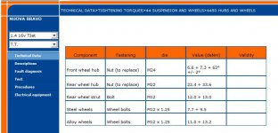

Hi there, does anyone know the size of the hub nut on the front wheels of a tjet?
Bravo eLEARN says M24:
Thanks, it's a 36mm socket size
