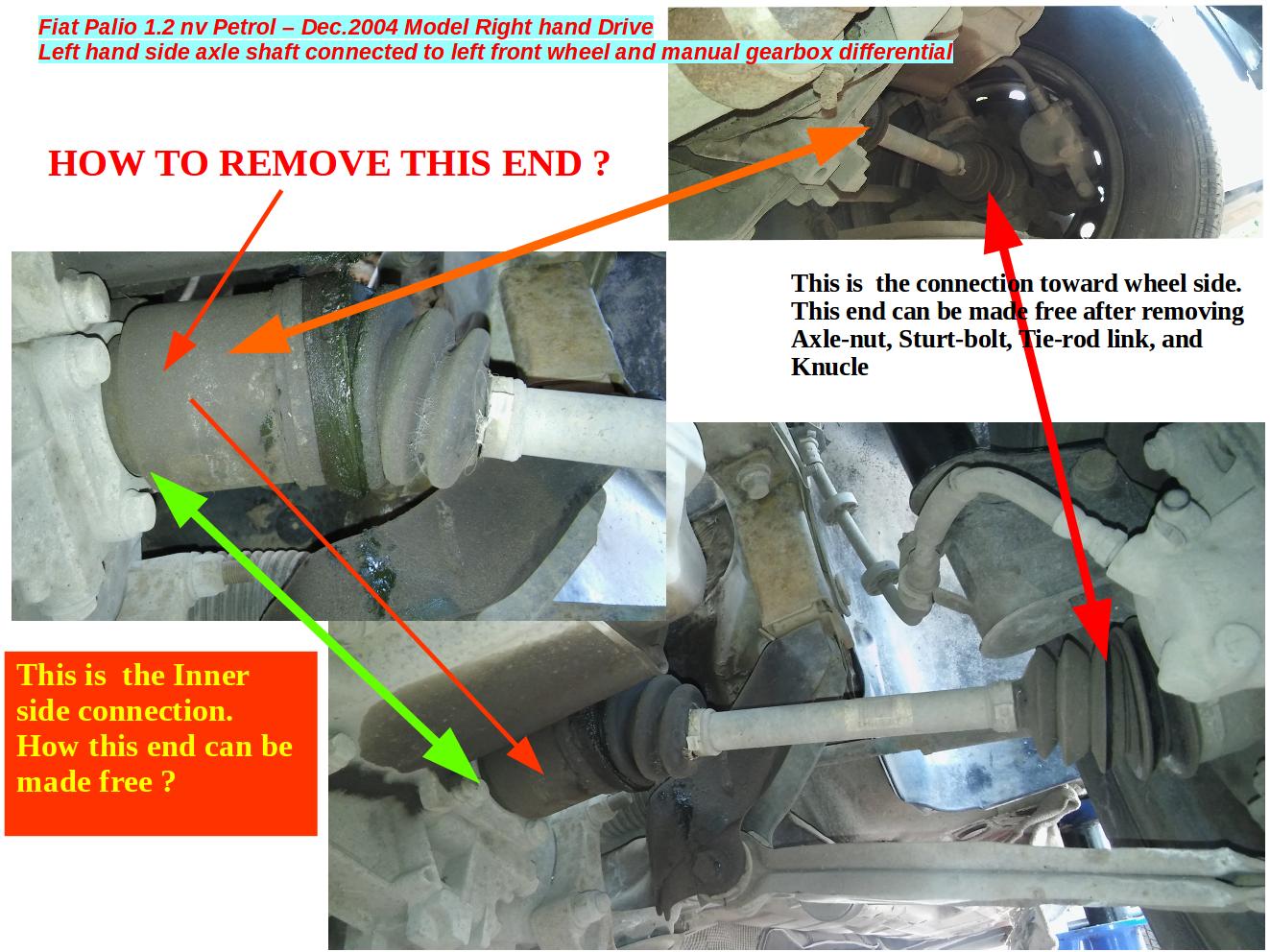

The actual situation is as shown in the picture.
To replace the rubber boot comfortable, I must remove the axle first. The wheel side end can easily be made free br removing wheel, axle nut, tie rod bolt, lowewr arm bolt and knucle.
My confusion is about how to remove the other end, i.e. the end linked inward side toward gear box differential.
It is mentioned in the picture. Please guide me in detail.

Dear Peter,
I referred the links you sent.
from picture in #3 you can see the difference in shape of the linked part (cylinder shaped) and the boot is clipped away from the end. The shaft as a whole along with the rubber boot rotates with the wheel(refer my uploaded video above). In most of the videos I referred, it is mentioned to remove the oil either in case of automatic gearshift devices or diesel cars. In petrol cars it is not required to empty the gearbox by draining the gear-oil. However, I am not confident about the situation and so 'am trying to get the information prior to carry out any DIY operation.

Sir.
I think, in the Fiat Palio 1.2 nv there seems no oilseal at the place from where the axle comes out as per the sketch uploaded here.
  • Palio-Drive_Shaft Bridge & Axle Shafts.pdf
Dear Peter,
I have got a one of the feed-backs as under:
".......I have never worked on a Fiat Palio before but as per my knowledge after freeing the outer end of CV join we can wedge out inner end using a pryer.
Just place a rod/pryer/C-lock between inner end and casing and push it outside. If it doesn't work, rotate the axle and keep on trying it and at one point it will slide out.
The inner side of axle is locked in position by a retaining lock and a slot. When these two match we can slide the axle out......"
I feel that simply carefully pulling out the whole shaft (after making its wheel side end free) will do the job. In most of the videos on YouTube it is shown as that.
Your opinion is requested.

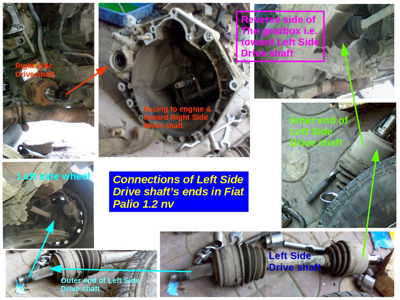

Friends,
I have done the theoretical home work at my best about the captioned drive shafts linkages and connections with other components in the car. Ofcourse, may not be perfectly true but to the best of my knowledge and efforts, I feel it very close to real situation. Any deviations in the situation or judgement couild be rectified or resolved while actually doing the DIY job in the matter.
I upload the picture which itself is a self-explainetary, so ‘am not nerrating it here but shell proceed in DIY of the issue.
Update will be posted, meanwhile your valued feed back (if any) will be appreciated.

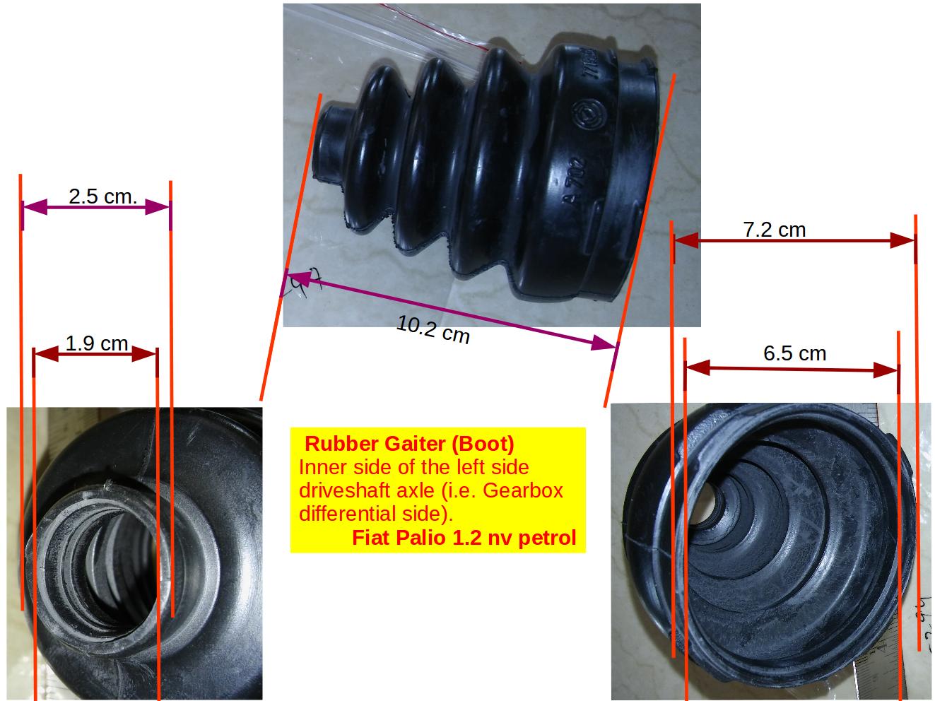

I procured a new Gaiter/Rubber-boot and its Collars for the inner side of the left side shaft from 99rpm which I could receive with in a week. Also purchased Grease for CV joint from local market. “Servogrease CVJ” is very specific but is not available usually in the retail market as it usually comes in large (barrel) packing as per vendors. The cvj grease I purchased is APJ brand transparent red colored one. I bought 2X75 gm packs each costing Rs.40/-

Carefully hold the whole axle straight with two hands, make the outer end free. With the help of other person, wedge out the inner end using a flat hard strip or similar tool. Just place a rod/flat hard strip/hard screw driver edge between the differential casing body and the shaft end-can and uniformly press through leverage action outward to let the axle slides out. During this you may need to little rotate the axle clockwise and anticlockwise to let it come out as there is a lock ring in the grove at the end of the axis (which helps it locking inside the differential assembly). Finally it will come out. The operation is not so hard. In my case, as the gaiter /boot was teared out, the end of the axle with with a spider came out and a can-shape housing (accommodating spider/tripod) remained attached to the differential. So it was removed after taking the shaft-rod out. The cup was easily removed as described above.

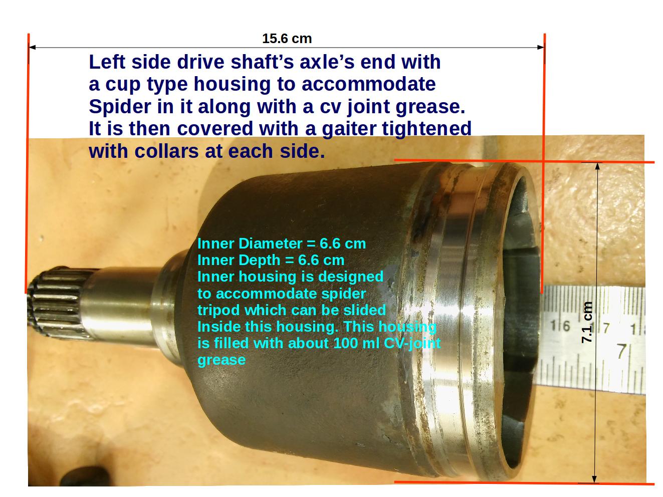

Both the parts of shaft ( Inner end with cup + outer end with boot/gaiter and shaft rod) were taken out on the floor, cracked boot and its tightening old collars were removed. Both parts were cleaned of old grease. The tripod/spider was pulled out after removing the circlip from the shaft end. Everything was cleaned by a soft cotton cloth. Again the Spider was reset and locked with circlip.
6.
On the spider holding rod part, insert the Gaiter/Rubber boot 's narrow side and fit it with small collar at its original position (old markings appears on the shaft rod). Then fix the spider and lock it with a circlip (Snap-ring) as it was.
7
Take the inner-end cup and fill it with cv joint grease. Usually it is found that about 70 to 120 gm of grease is required in different cases. Here I used about 100 gm to fill it. Stir the grease inside with a small iron rod(screw driver rod) to remove air gaps inside.
8.
Let the rod with spider be rolled in carefully, little grease will come out. Re-paste it inside in such a way that no air gap or bubble/cavity remains inside and the material covers the spider from outside also. Too much grease is not required as it may exert unnecessary pressure on rubber boot from inside and may damage while the car runs. Extend the wider side of the rubber boot and cover-up on the can-shaped spider housing up to its original mark and fit it with a larger diameter collar. There is also a grove there. Now the complete axle drive shaft of left side is ready. Fully clean it with a cotton cloth. It is now ready to install.
