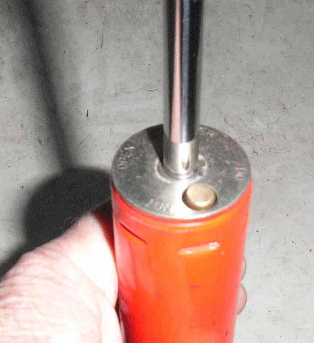

I found how to do it. Take off the plastic shroud/cover and aha, here goes a little button. Press it in, turn the piston and all is good.(y)
See above: I will explain.
I had looked and read the instructions on the shockie, but couldn't figure it out.Not being a smoker or a lollie eater i didn't have anything to do while I contemplated it. So I went and put some wall linings in my campervan. I should post a pic of the van on here, but you can see it on my facebook page.
Anyway, looking at the shockies I wondered if the top shroud would come off, I had tried before, but this time I pushed it a bit harder and it popped off down the shockie. It is only plastic and covers the piston.
It exposed a little brass button, if you push the button in and turn the piston you can adjust it. You can feel it happening. Now they are even and on the soft setting. When I got them they were uneven.
some people help out on many clubs, these days i zip through to quick i apologise!! rawill, do you still have to remove them to adjust, never was a good idea, after lots of playing with adjustable suspension i tend to have them slightly harder at the rear personal preference, Ant!
I wasn't complaining, no need to apologise. Thank you for your interest.
Yes they would have to be taken off the bottom mount and then take off the shroud to press in the button to turn them. So in fact they would be no good for a track or rally car that you wanted to experiment with. These will be on my road car, (I hope a wolf in sheep's clothing - sleeper)
