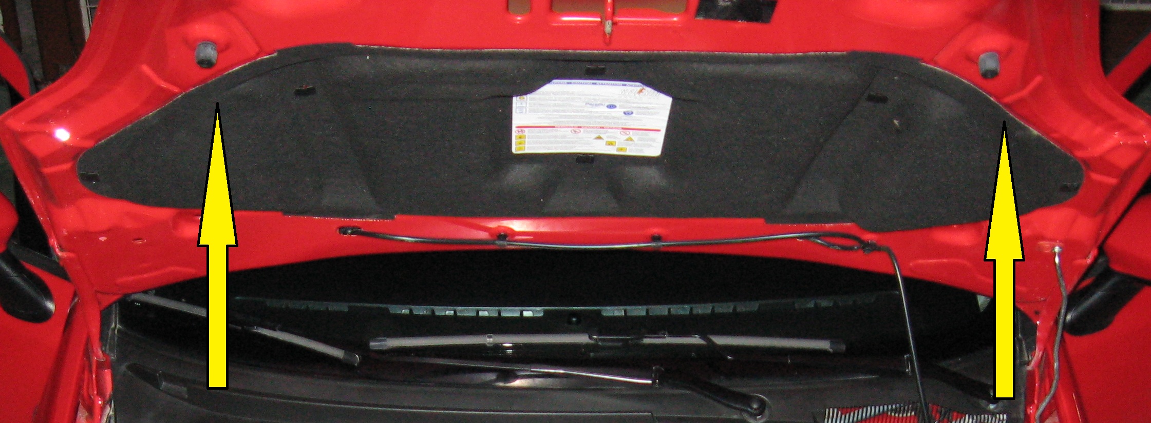

could you elaborate please as the gap between the bonnet and front bumper is quite big but all the other gaps line up perfectly :confused:
You screw/unscrew these in order to adjust how high/low the bonnet sits/
Just be careful,leave a small "reasonable" gap because in case of collision the bumper is very flexible and you don't want to hit your bumper.
