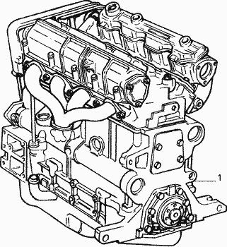

The 66 kW 1.6 DOHC was based on 2.0 DOHC. It was used from 1988 to 1990. It has very poor reputation as far as fuel economy is concerned.
Are you sure it was a 1.6 and not a 1.8? All the 1.6 are SOHC.
The 1.8 (1750cc) is based on the 2.0 and there is a 66kW DOHC version.

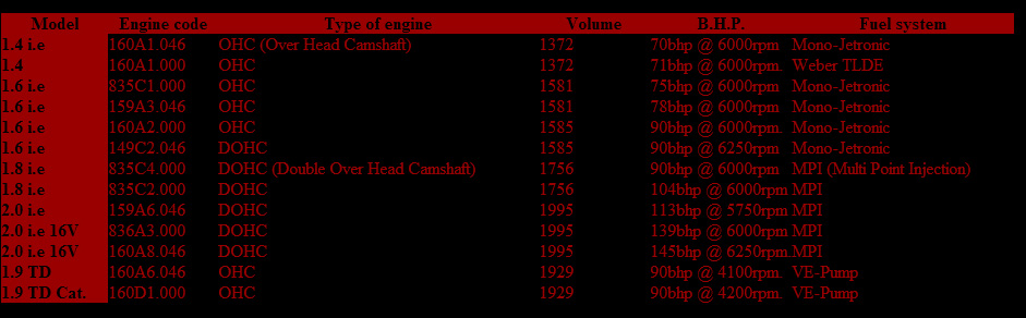

here are the engine codes
my tipo is 1.6 dohc 90 hp(66kw)

It is not surprising that Fiat did a twin-cam 1600 Tipo, this engine was very sucessful in the eighties. It went into the SuperMirafiori, Strada/Ritmo, Regata, and the Lancia Delta GT/GTie and the Prisma. In no way is it a "bad" engine, but for most markets they probably offered the 1.8 twin cam Tipo, and remember the original 1.6 SOHC with the Weber carb was much quicker than the later ones with SPI and cat.
Respect is due to all Fiat (Lampredi) twin-cam 8V engines! Especially in the Tipo!
