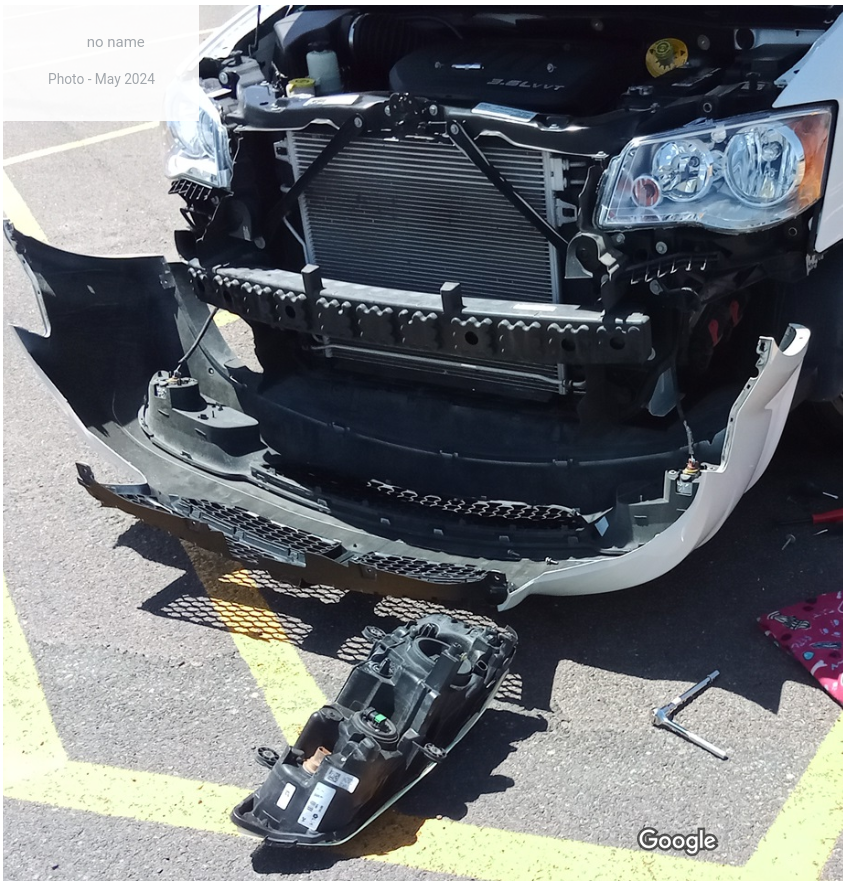

Run a bead of clear silicone around the seam of the light housing, provided there is a seam. If wires are running through a grommet perhaps change the grommet or seal that up as well with the silicone. The lights have to breath to let the heat build up out, so be careful with the silicone or they may melt. And halogen burns hotter then led. If they are incandescent type should be ok. I had to change my entire set out on my van earlier this year after moisture got into them, and what a job that was.

Yes indeed ! It doesn't have to breath, cover it up.
