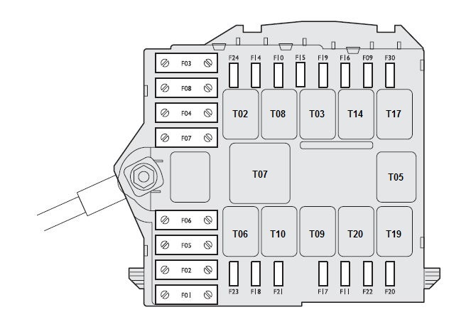

Check fuse F10 and relay T3, both in the engine compartment fuse box.

None of that makes any difference, stestilo - it'll be the same horn.
Take the wheelarch liner out on the driver's side (assume RHD) and you can see the horn. Check the connections, and test the horn by dabbing the + terminal with a length of wire straight from the battery. If it honks, you know the fault is in the wiring and you just need to trace back through relays, fuses and switches.
(to test the relay, look for an identical one in the fusebox and temporarily swap them. If your horn suddenly works but your wipers suddenly don't, it's the relay)
