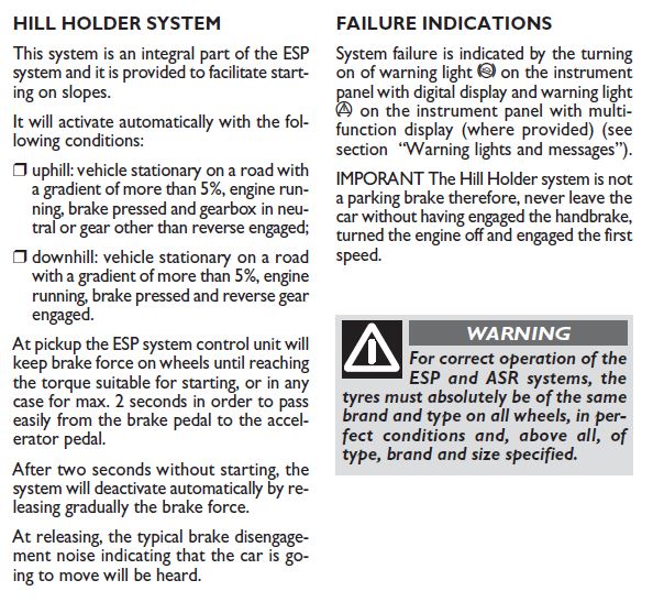

Hill Holder is exactly what it says.... it holds the car on a hill. ;) Explanation from page 92 of the owner's handbook below. If you don't have one, you can download the full handbook from the forum downloads section here: http://fiatforum.com/downloads.php?do=download&downloadid=162
