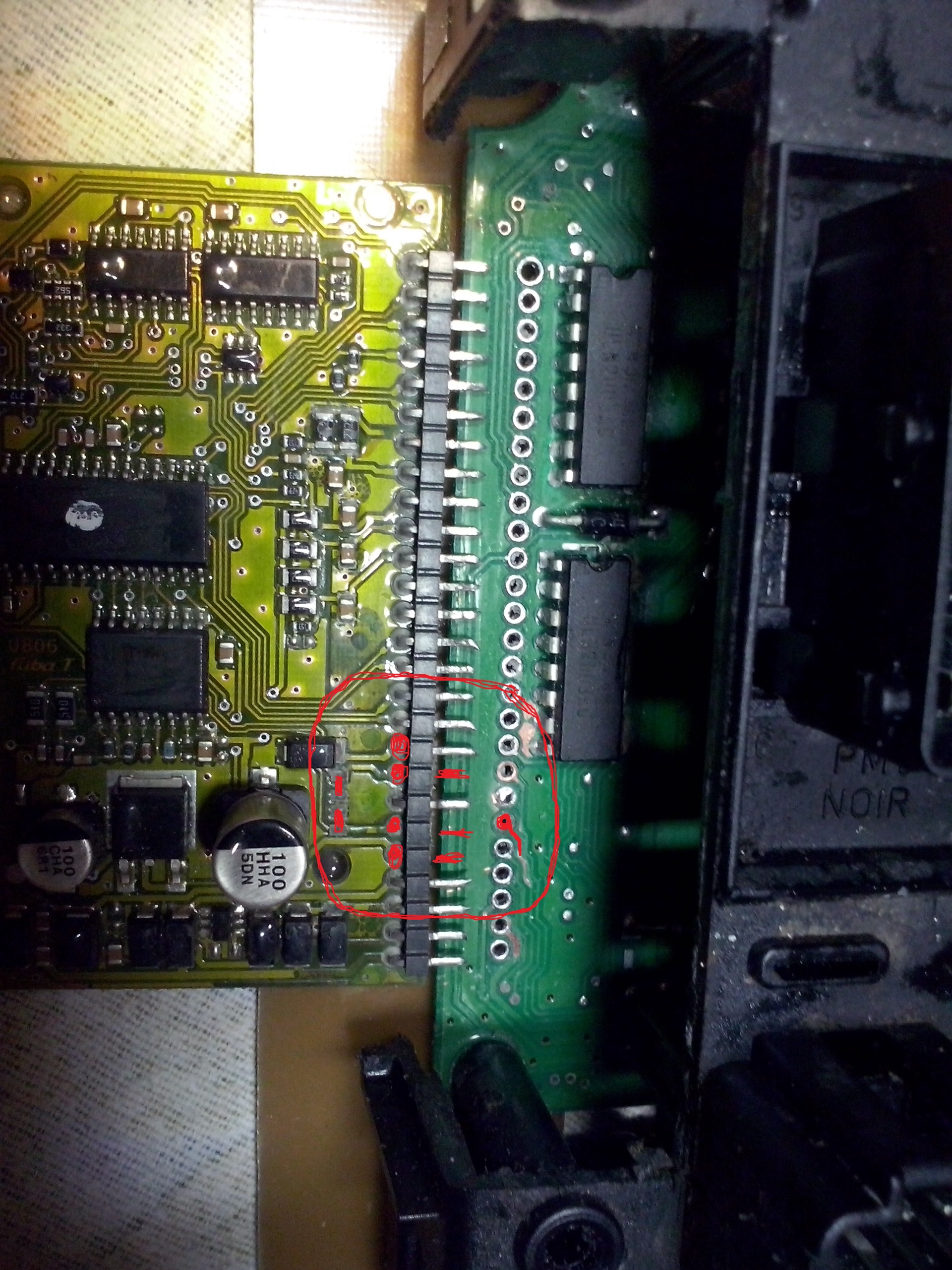

After lots of reading I had a look at the BSM module and found some problems, loads of moisture inside, cut wires (?) and corrosion on fuse terminal and in the green plug.

Does anybody wonder what happends (damage) inside the BSM module ?
Have a look at the pictures
Picture 1 mainboard track and via completly corroded and missing
Picture 2 controller board connection pins (4) and 2 capacitors completly corroded and gone
Picture 3 board side by side with damage marked up
Going to see if I can save this one

Well one problem sorted...
After rebuilding 6 tracks on the circuit board and replacing the pin strip it works :slayer:
Capacitors are now on the bottom of the board.
