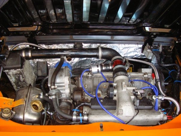

Many thanks for your advice. Despretley seaking MK2 spares but coming up with nothing. Didn't quite realise how rare these were when I installed it. If this helps I am also a member of Turbocollective. Which is mainly a UT site and I have managed to upload a picture of my engine bay. This might show a possible fault with my installation.

I have attached a pic of my engine bay to see if any obvious faults. I don't have original dump valve anymore.

The air flow meter is on it's side,don't know if it'll work as effectivley as the right way up & it looks like you haven't blocked off the old dump valve outlet on the black pipe going to the intercooler which will loose boost & make the car run roughly. Have you cleaned the aux. valve out with brake cleaner as they've been known to clog up in the past. I'd also check/sqeeze every boost pipe & check for splits that may only show up/open under boost(common problem with punto gt's) .
I think that afm has a door/flap that opens when the air is sucked through it.If that afm is on it's side then gravity may be opening the door/flap prematurley giving your fuelling a over reading from the start. It's been 5+ years since i've had a mk2 so i could be wrong. Prefer my mk1's;)

Have you pluged up that hole?

Right guys cheers for replies. Yes the hole is bunged up. Many X19 conversions have the AFM like this and theres work :cry:.. The rich thing is down to smell and the popping from the exhaust. Timing is good though it constantly changes it when you try to time, autuomatic I believe. New plugs and leads etc. Compression also spot on. Aux valve been cleaned out and seems ok. Though not tested on another. But it runs crap even when hot.

Can you explain to me how it tried to drive? Have you pluged the hole where the old recirc. valve connects between the turbo & the air flow meter? The same black tubing between the afm & turbo looks twisted in your pic & they have a habit of coming off slightly turbo side which gives erratic running problems. On Uno t's the aux. valve is bolted to the block,does it need to be earthed?
