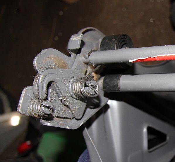

Your front hook locks will be in this state...
Simply grab the two bars at the front and squeeze them together...
This opens the hooks (A), and the sprung-loaded latch (B) should keep them in the open position.
Now you slip the slots over the bars in the floor (front end first, seat base tilted near-upright) and push down, the hooks should release and lock on.
Then simply drop the back end down and the rear hooks will latch.
A little WD40 on all the moving parts will help everything stay in working order.
Edit; If for some reason the hooks don't stay latched open (broken spring, or seized latch for example), you'll just need to hold the two bars together while you slip the slots over the bars in the floor.

Thank you both, I have sent him out there now with you instructions fingers crossed :)
It worked, looks like we have a broken spring. Thank you so so much. We can all go out in the bug again yay :)
. . . looks like we have a broken spring . . .
On one of the latches?
Quite common I suspect, only one of my three seats has a spring at both ends.
They're not very well secured, they simply hook into the open slot on the pivot.
Even if both springs are broken/missing, it doesn't affect the security of the hooks, it just means you have to hold the bars together while you're fitting the seats.
