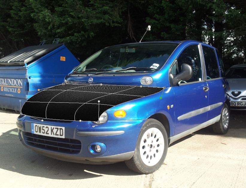

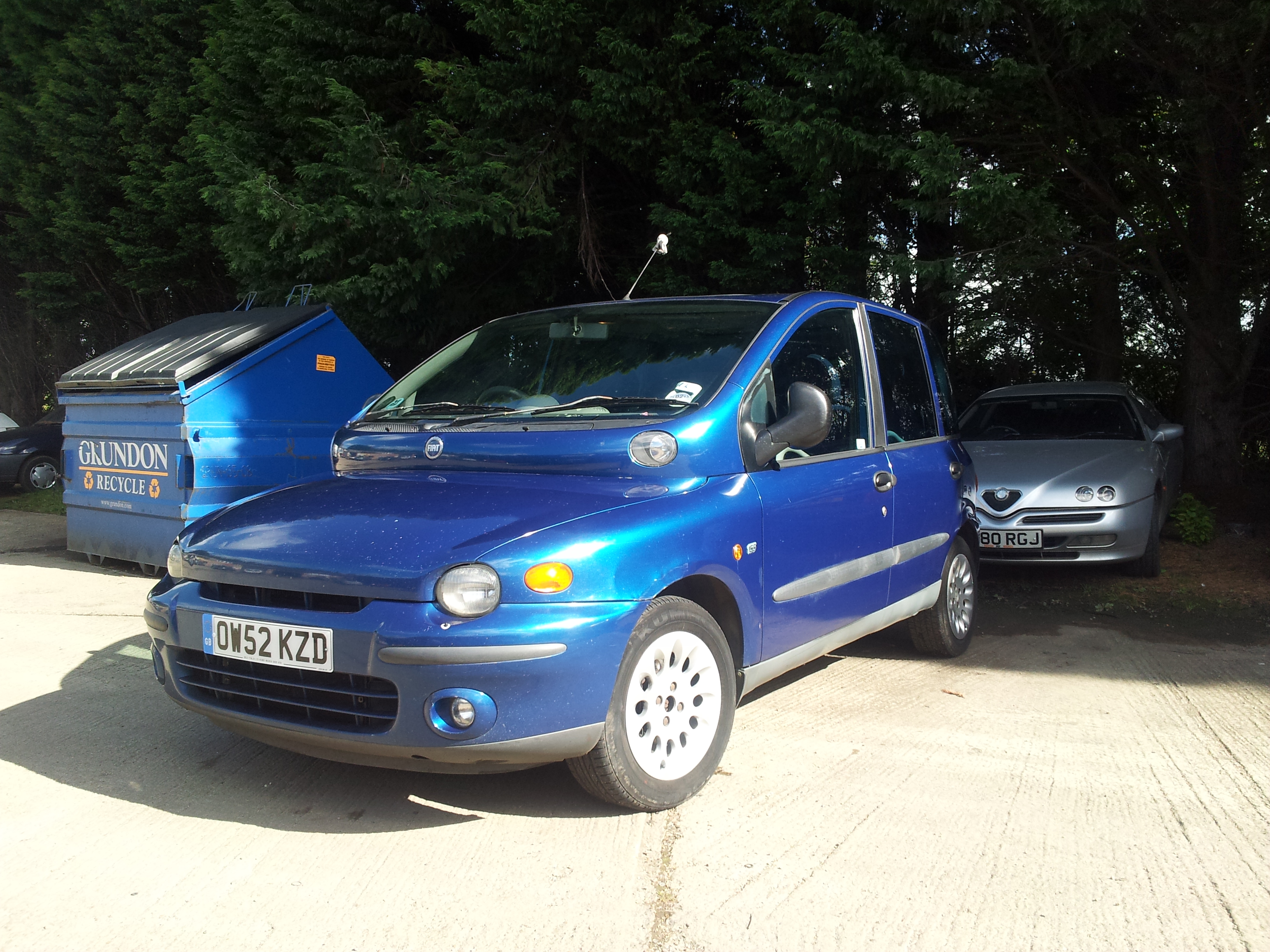

I placed the carbon texture into the Multipla picture as a new layer. I sized it so it covered the whole of the bonnet.
Next I used warp tool (right click on the layer bounding box and select warp) to shape the carbon texture layer to roughly match the curves of the bonnet but leaving a bit over the edge. This gives some realism to the texture as the lines follow the real lines of the car.
Next I trimmed the edge to the exact shape of the bonnet. Reduce the transparency of the carbon texture layer so you can see the bonnet underneigh. Use the point to point section tool with a 1px feather to cut the texture out using the outline of the bonnet. Once done, with the cut still selected, click the select tab and goto refine edge. Here you can alter the smoothness, feather and contrast etc to get the selection just right. Click ok when happy. With the selection tool still selected, right click on the selection and choose "select inverse". Then hit delete. This will trim the excess and you will now have a texture the correct shape.

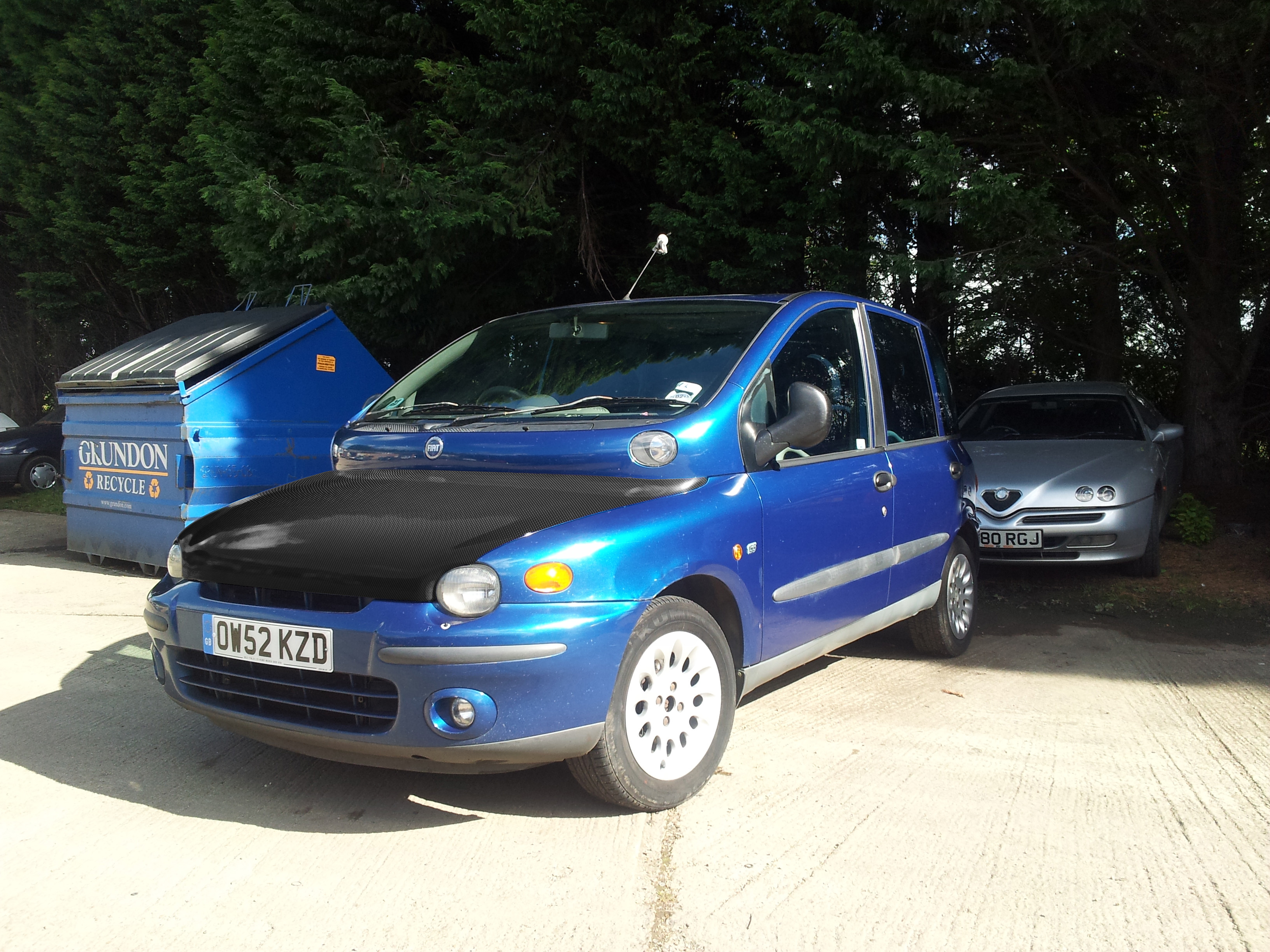

Right click on the carbon texture layer image in the layers tab, select "select pixels". This will "cut out" the area the texture covers. Now click on the multipla picture tab and click the image tab at the top of the screen. Go to adjustments then select "desaturate". This will make the carbon effect black again but still allow the relections from the bonnet show through.
At this point I also lightened the selection on the multipla picture slightly and reduced the contrast a touch. I also ran a dust and scratches filter on it too to get rid of the stone chips in the bonnet.
A few minor tweeks to levels later and all done
