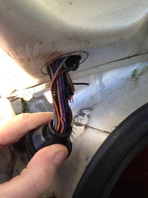

No you don't need to cut the rubber just pull it from the bodywork push it back on itself and then cut/remove the covering on the actual cable bundle.
A kit like this, is available; http://www.ebay.co.uk/itm/Repair-Se...728582&hash=item25e3e4eadd:g:lkEAAOSwm3pZ~HrN
Example.
