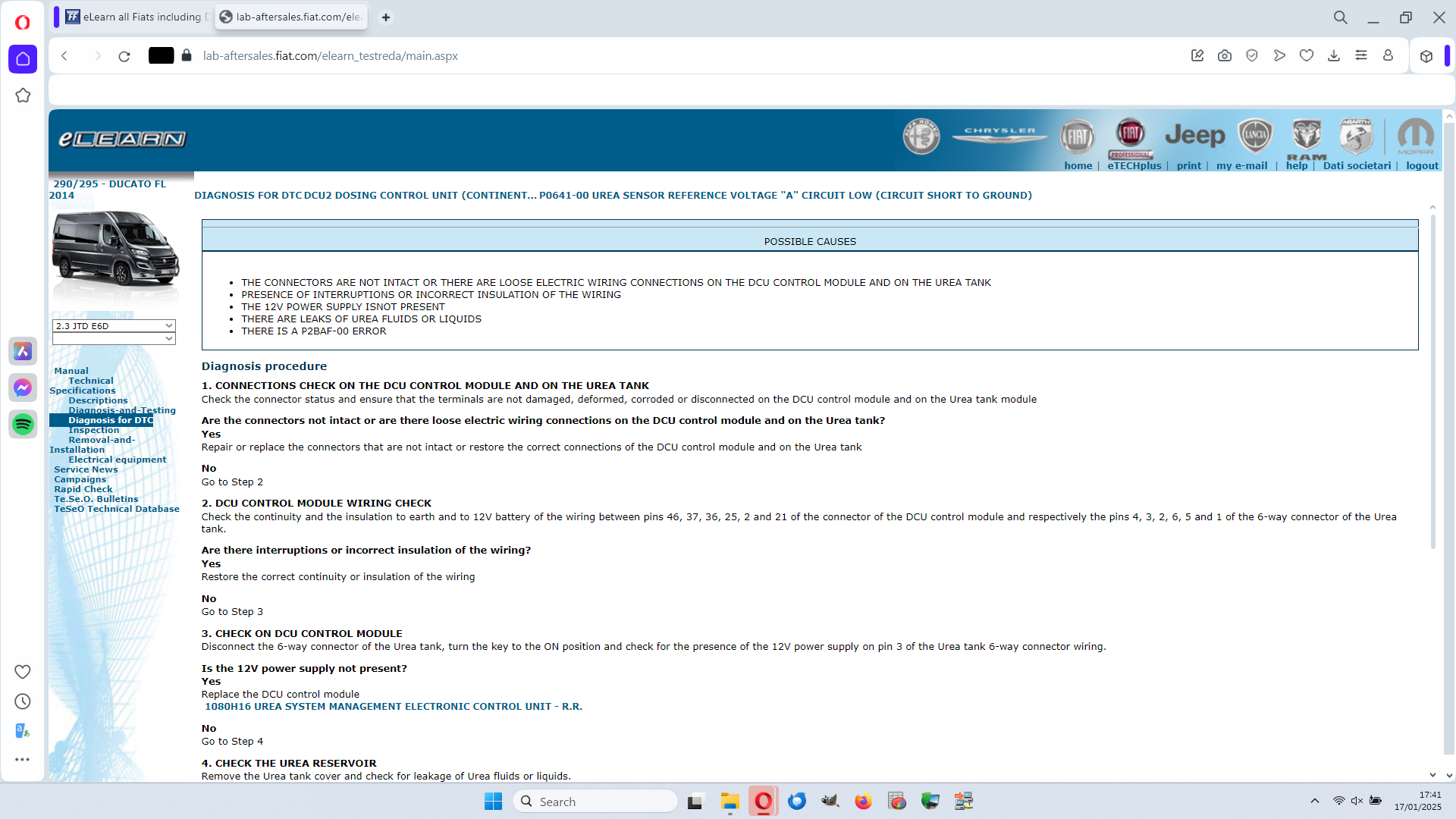

I'm a new owner of a 2021 Fiat Ducato 2.3 Multijetwith relatively low mileage (~30,000 km). The vehicle was recently left with a completely drained battery, and several jump-start attempts were made to get it going again.
Since then, the Check Engine Light has come on, and the OBD scanner at the inspection showed the following fault codes:
The codes were cleared by the dealership, and for several days everything seemed fine — the Check Engine Light was gone, and the car was driving normally.

From what I’ve researched and tested, it looks like the root cause might be related to the issue in the 5V reference circuit (P0641), and that all other fault codes are the consequence.

- P0641 – The engine control system has detected a problem with the electrical circuit that supplies reference voltage (usually 5 volts) to one or more sensors. This circuit is labeled as "Sensor Reference Voltage A."
- P24D1 – The system has detected that the pressure sensor for the diesel particulate filter is not changing its signal as expected. The signal appears to be stuck or frozen.
- P0236 – The engine control unit has detected that the signal from the turbocharger boost pressure sensor is outside the expected range or behaving inconsistently.
- P0238 – The engine control unit has detected that the signal from the turbocharger boost pressure sensor is higher than the allowed or expected level.
- Could these fault codes be caused by the battery being completely drained and the vehicle being jump-started multiple times?
- Is it possible that something was damaged during the jump-start process, especially if the cables weren’t connected or grounded correctly?
- Can a problem in the 5-volt reference circuit (P0641) cause multiple other sensors to fail or trigger related codes?
- Has anyone seen these exact codes (P0641, P24D1, P0236, P0238) come up together before? If so, what was the cause?
- Since the codes were cleared and the problem disappeared for a while, does that suggest anything specific?
