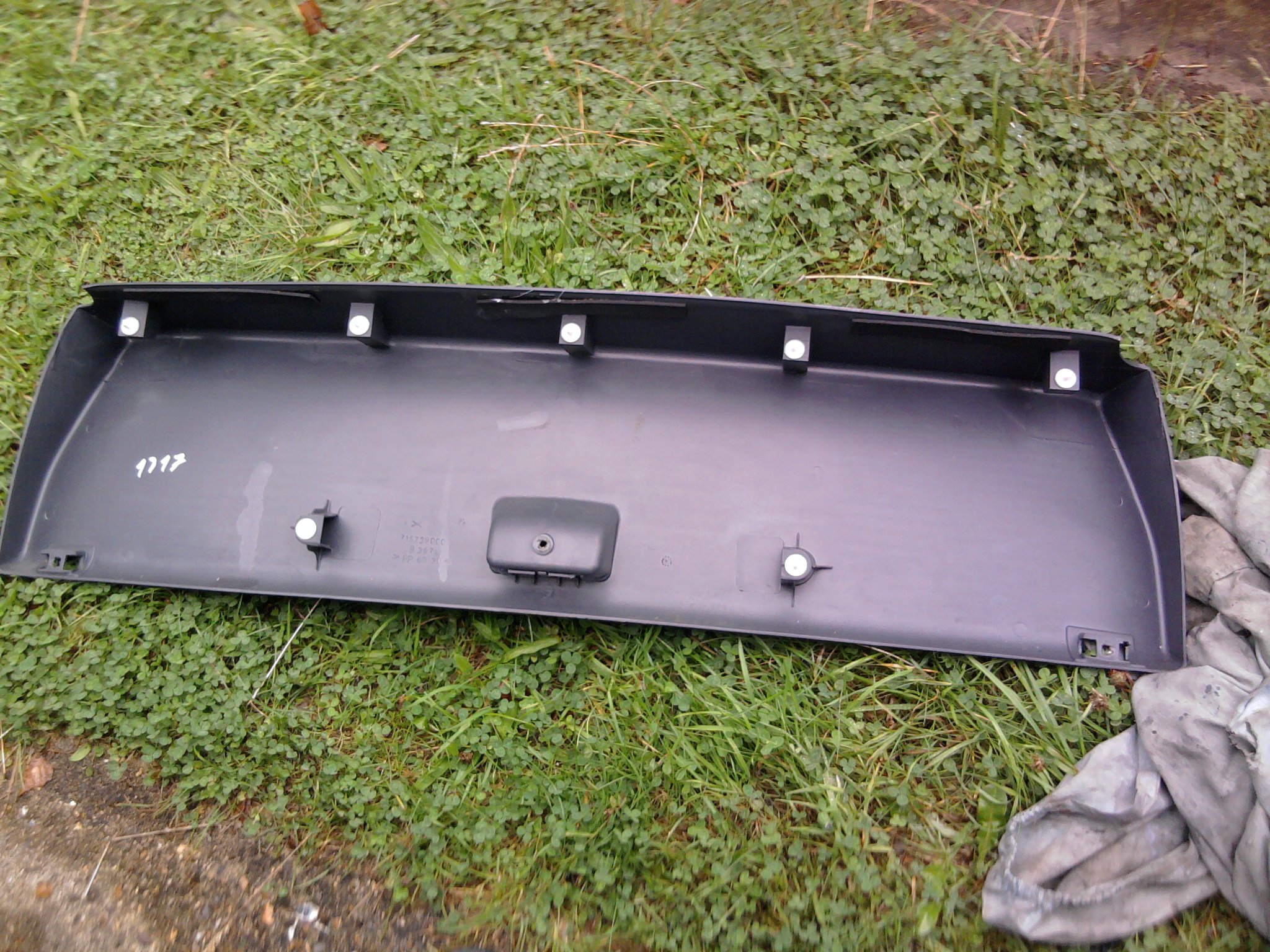

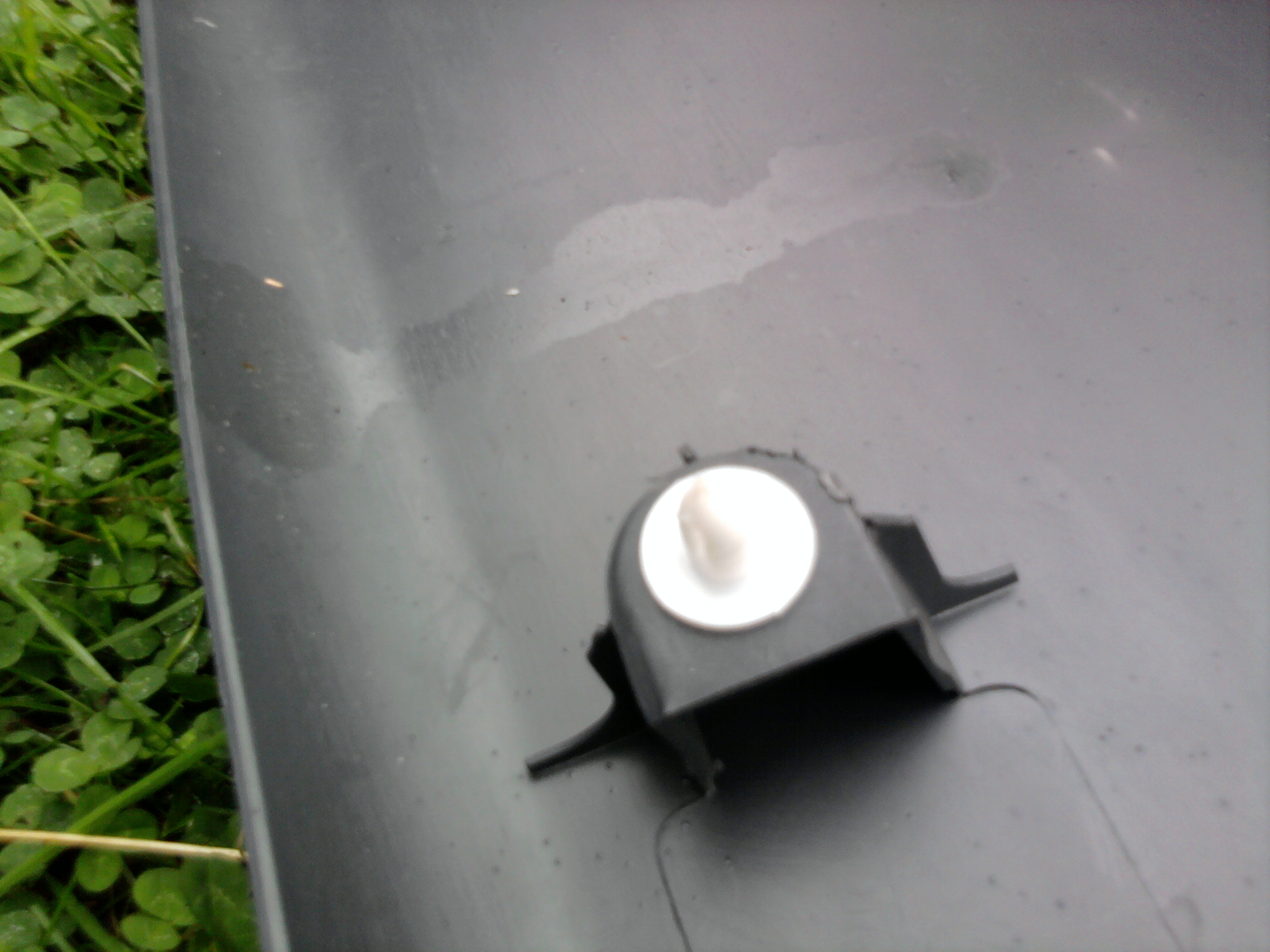

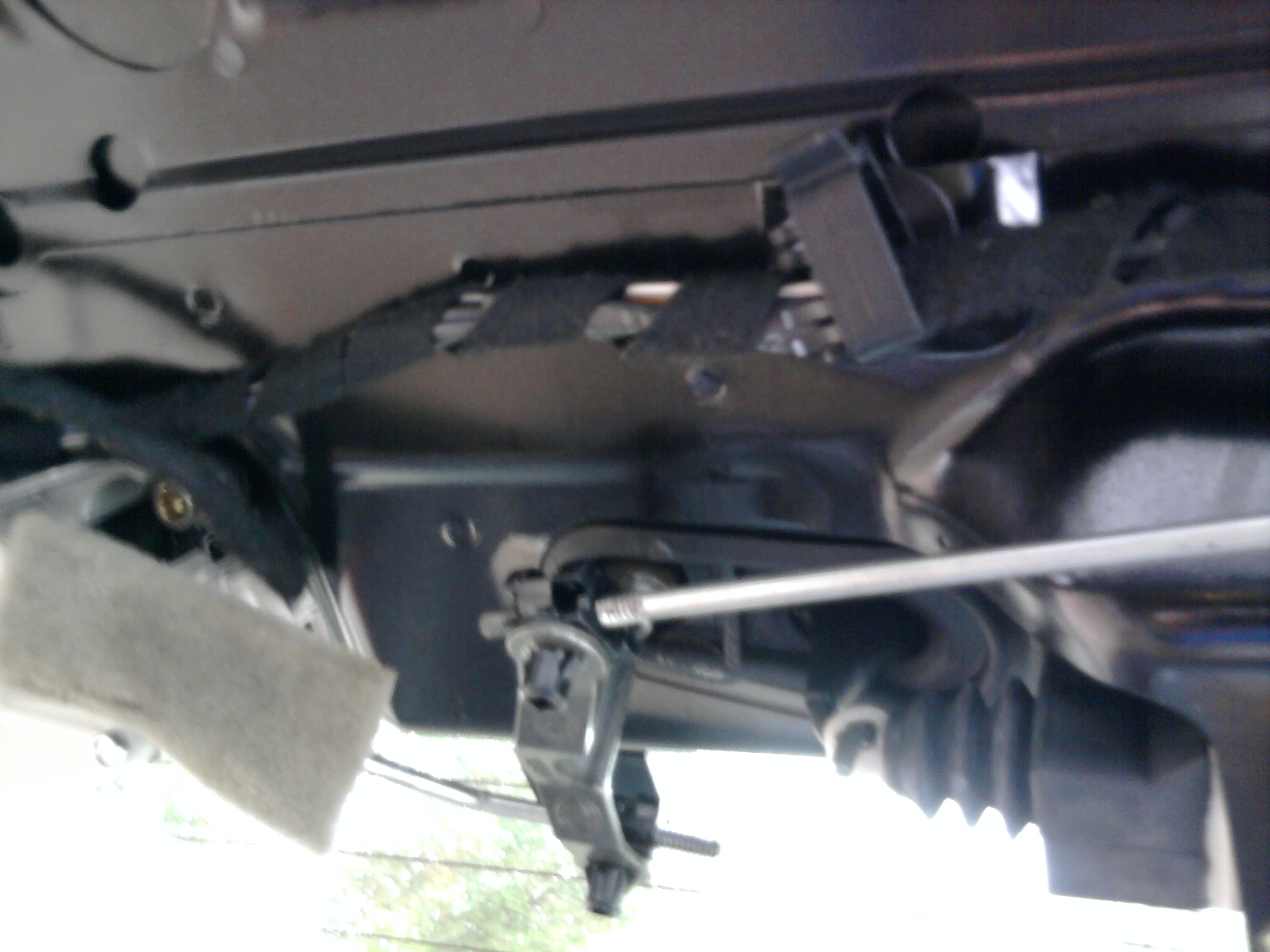

This problem came back again on my car. I eventually had to fix it by drilling out the holes on the nearside striker plate 2mm to give more adjustment. I was concerned that the moveable plate would just drop into some unreachable area and rattle around. Removing the side trim showed its captive. If it happens again I can remove and use a rat tail file until it shuts again. It must be the tailgate twisting with age as the bottom opening shuts fine.
It was also suffering with a jamming handle so i peeled off that rubber and oiled it and its working fine now. Just in case I put a self tapper in one of the holes that the rubber overmould keys into so I can pull the handle down if (when ) it jams again.
I uploaded a few pics so those new to these cars can see whats inside the trim
