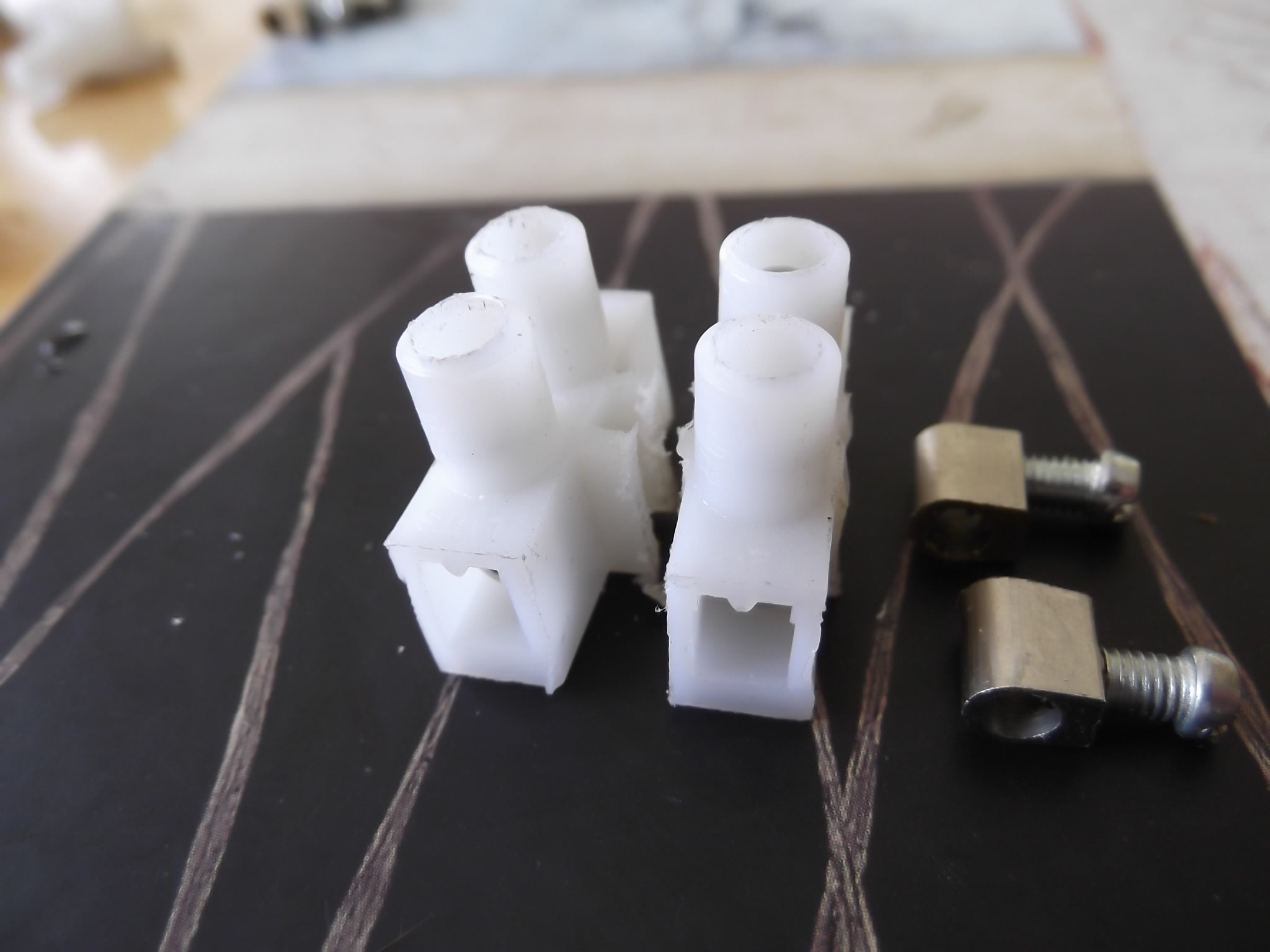

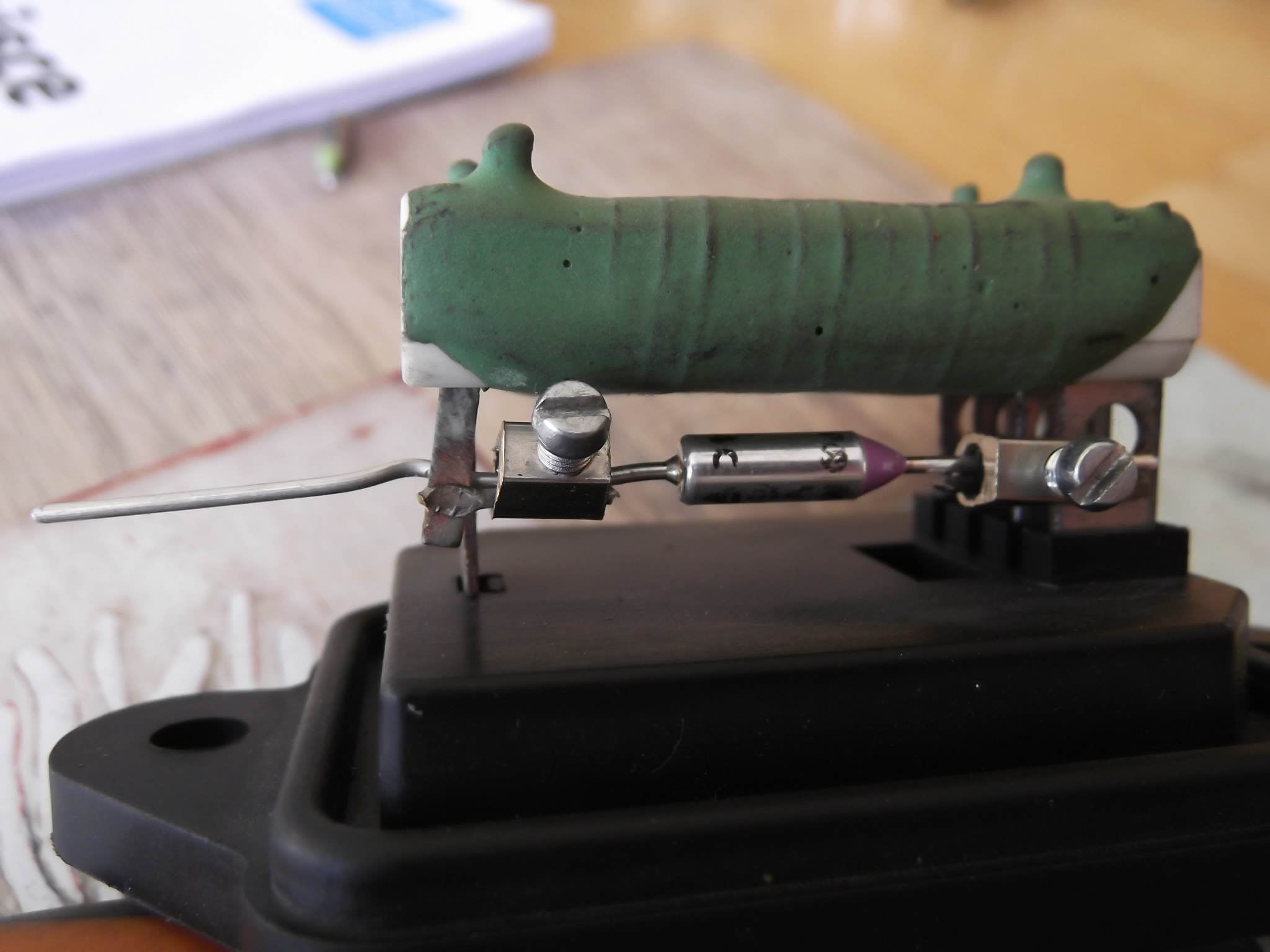

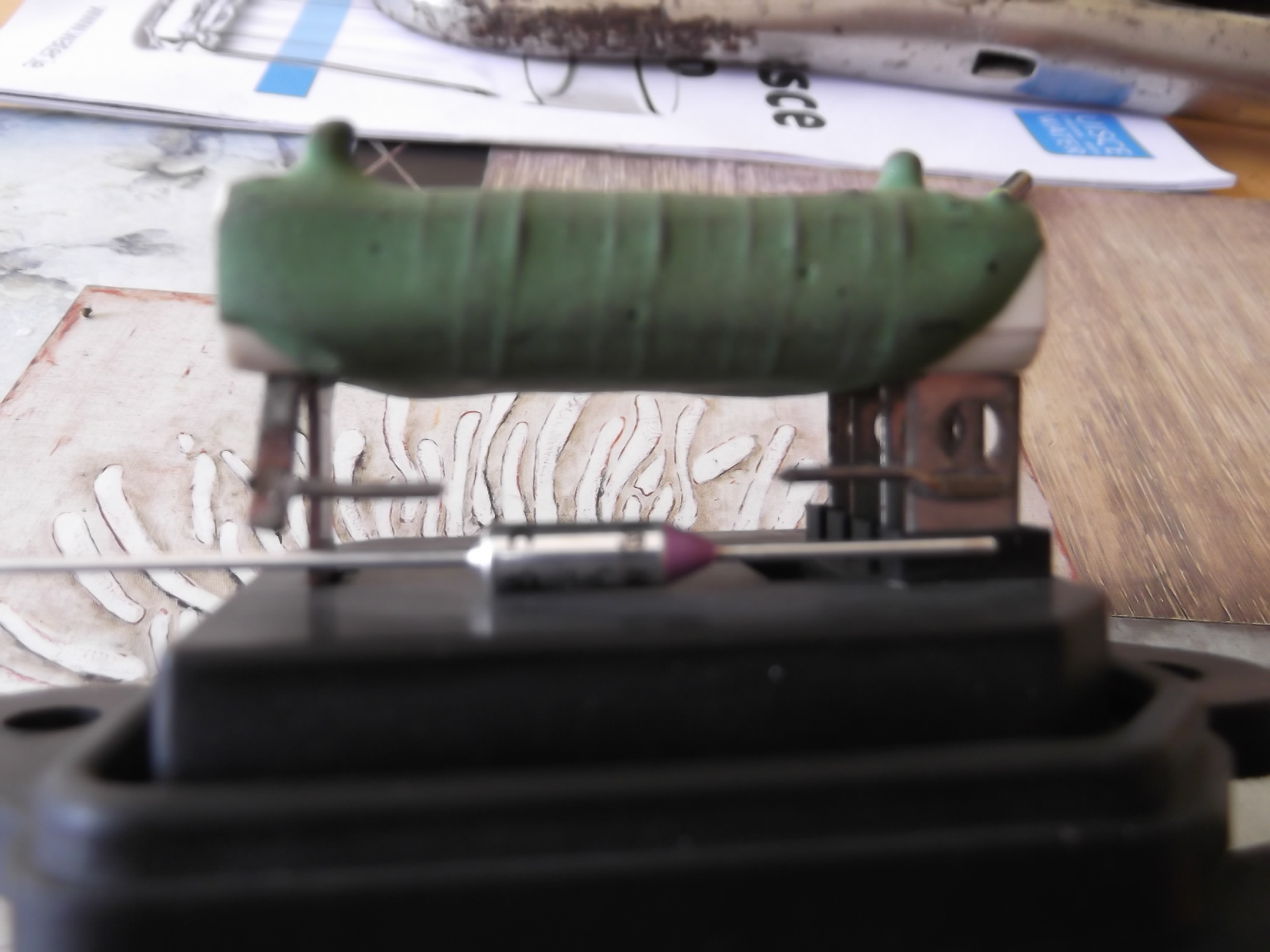

OK, I did a bit of searching, I went and got a thermal fuse 184 C, That was the only one I could get, I think the original may be 215 C but not sure, too hard to read. I snipped the old one out leaving enough of the connecting wire to attach the new one to. I didn't want to have to silver solder the new one on due to heat problems with the fuse! so I got an old electrical connector block, cut it in half , stripped the plastic off and used this instead, simple and effective, connected up and hey presto it works!. The problem to start with was a half seized fan motor, Freed that up and ran it in the lathe for a while, plenty of oil on the bushings, and now all is fine, BTW the fuse was about €1.20. Hope this helps somebody. Pics attached.
