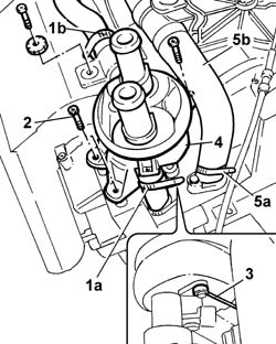

Below is what I found in eLearn. I am curious as to where item 5b terminates. The highlighting is mine.
The complete section may be viewed here, but it does relate to the x244 model.
"1. Remove the bands (1a) and (1b) retaining the heater radiator supply and return pipes.2. Undo the bolts fixing the tap.- Open the tap control cable retaining spring.3. Disconnect the tap control cable and remove it.4. Disconnect the heater radiator supply and return pipes and remove the tap.5. Remove the band (5a) and remove the flexible pipe complete with connector for bleeding the cooling system (5b).
So from the sound of that, then it does have a control valve at the heater matrix, this may be a problem then for the OP as he wants to fit that auxillary heater.:(
Unless he thinks it viable to set that valve permanently open so his auxilary heater will be able to circulate the warm water through the whole system.
Is that valve part in picture on the heater unit inside tha cabin?
Yes. All that I can see in my engine bay is the upper (heater end) of the two rubber hoses. A view of the thermostat housing end would require some dismantling or use of a borescope.
