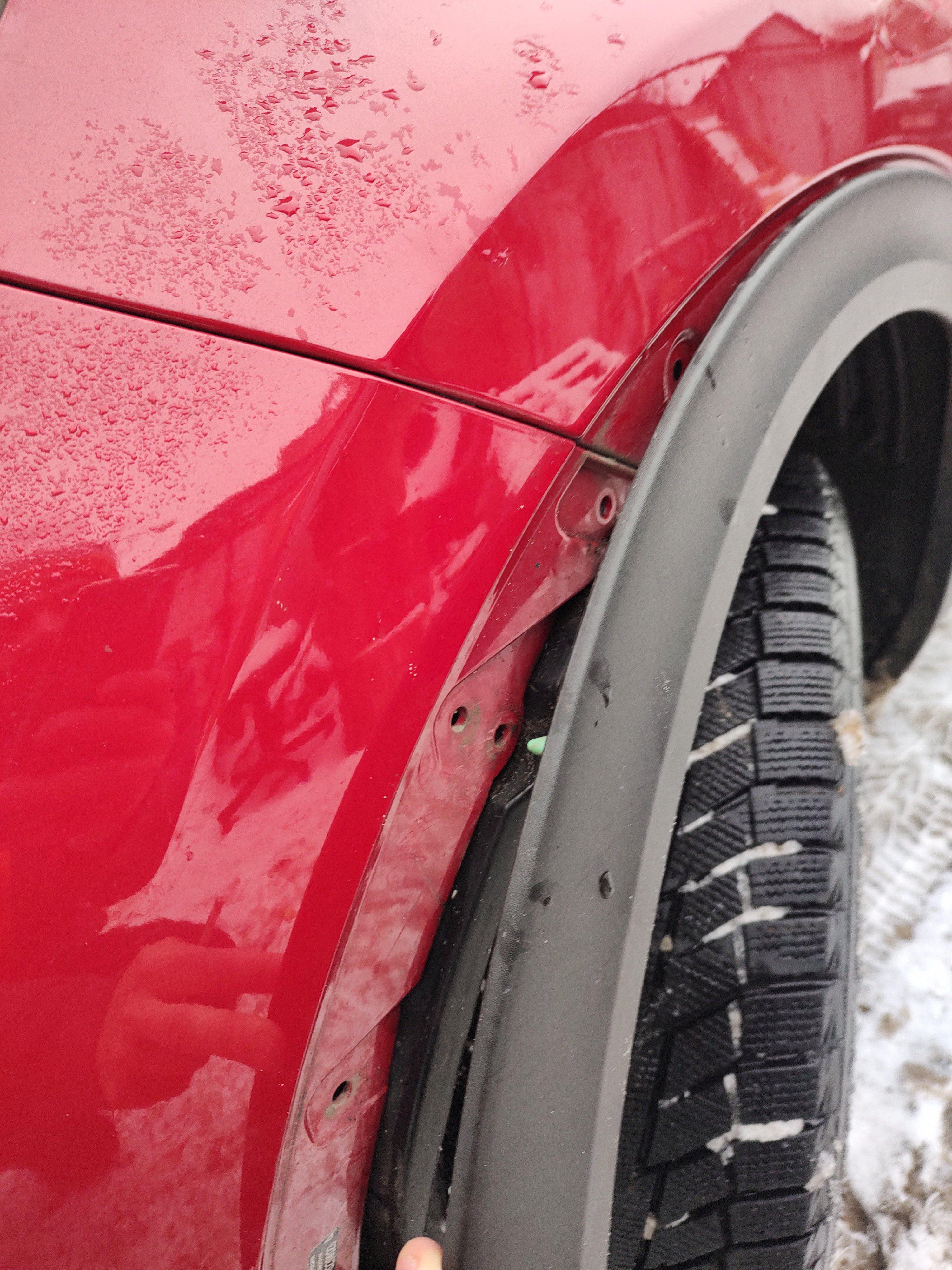

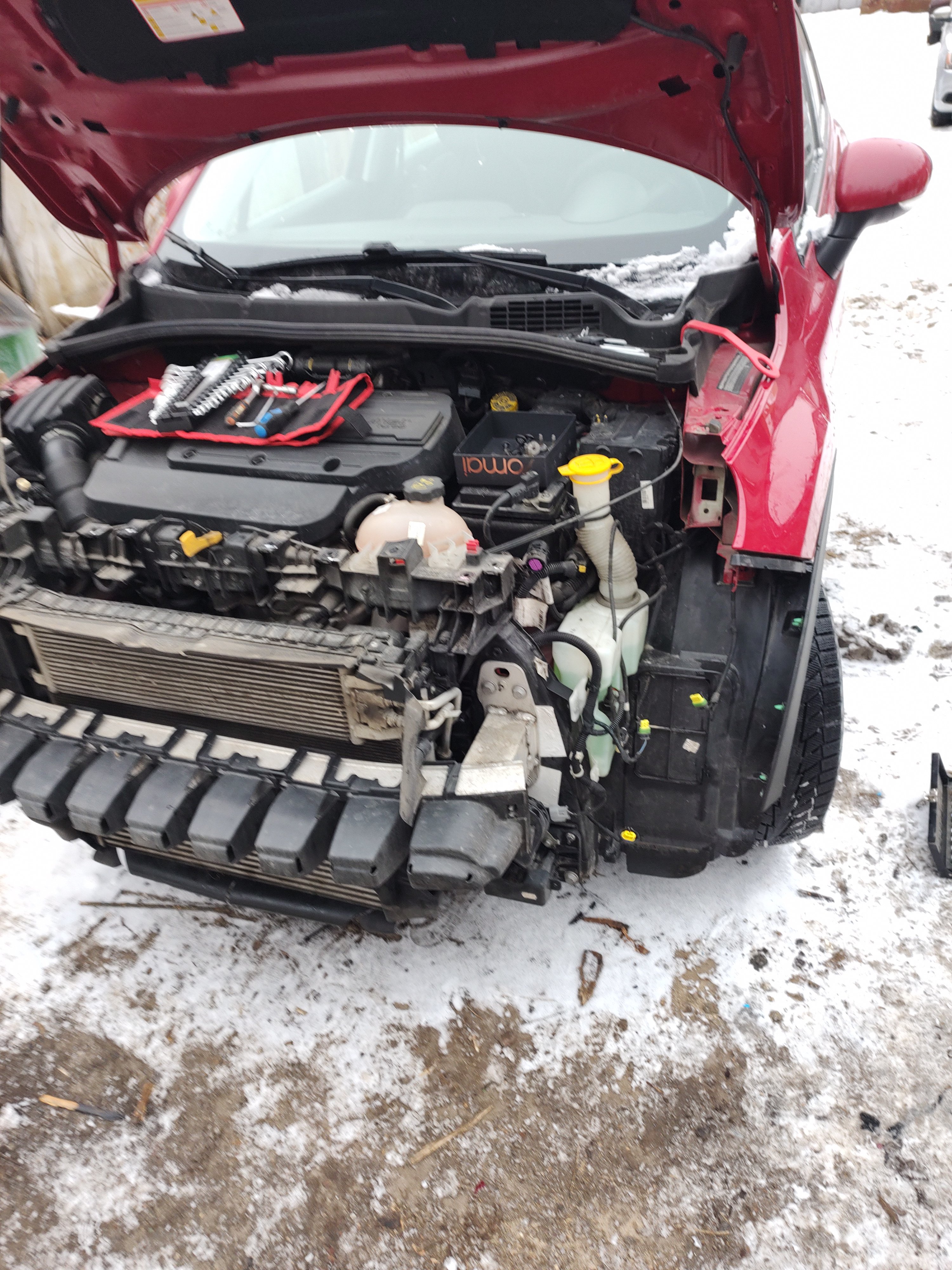

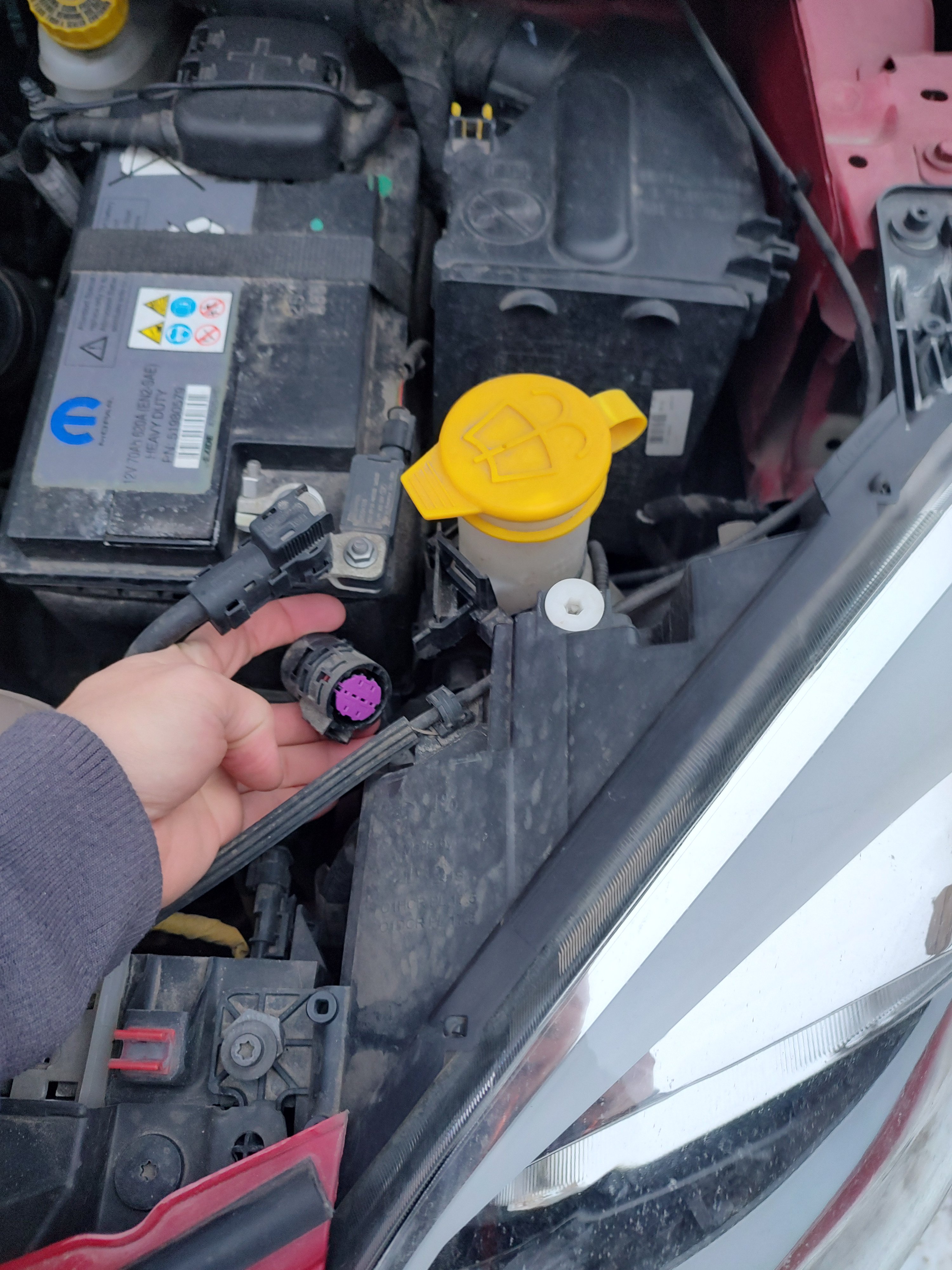

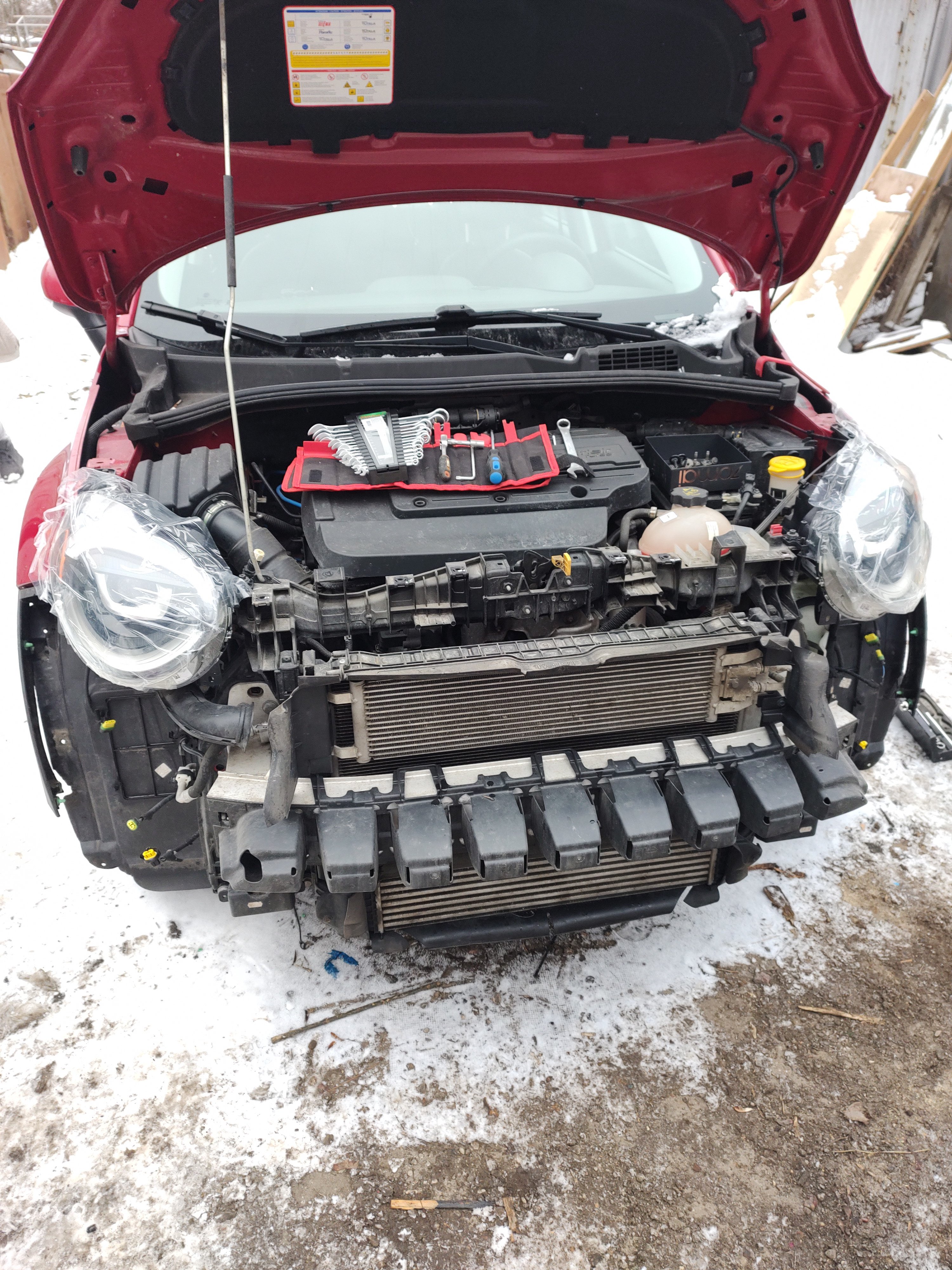

I have fiat 500x 2107 cross and changed headlights to OEM Full LED last week.
Lights will work
no errors on dashboard
Fits well
Light is way better than before
But. issues you will face
- front bumper has to be removed - it's not hard, but to disassemble you'll need to disassemble plastic parts above tires. They are mounted on plastic clips which brakes very easy (on photo)
- driver side headlamp - wires are shorter. You'll need to tight them
- and basically how i get to this forum) Headlight level adjustments is not working (near headlight switch). I suppose this is related to connector pins and looking for diagrams - can't find anything.
hope this helps
PS sorry for mistakes, English is not my native

Oh, completely forget UK has driver on the right... in this case shorter wire is on passenger side)
