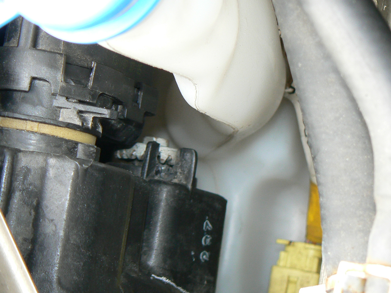

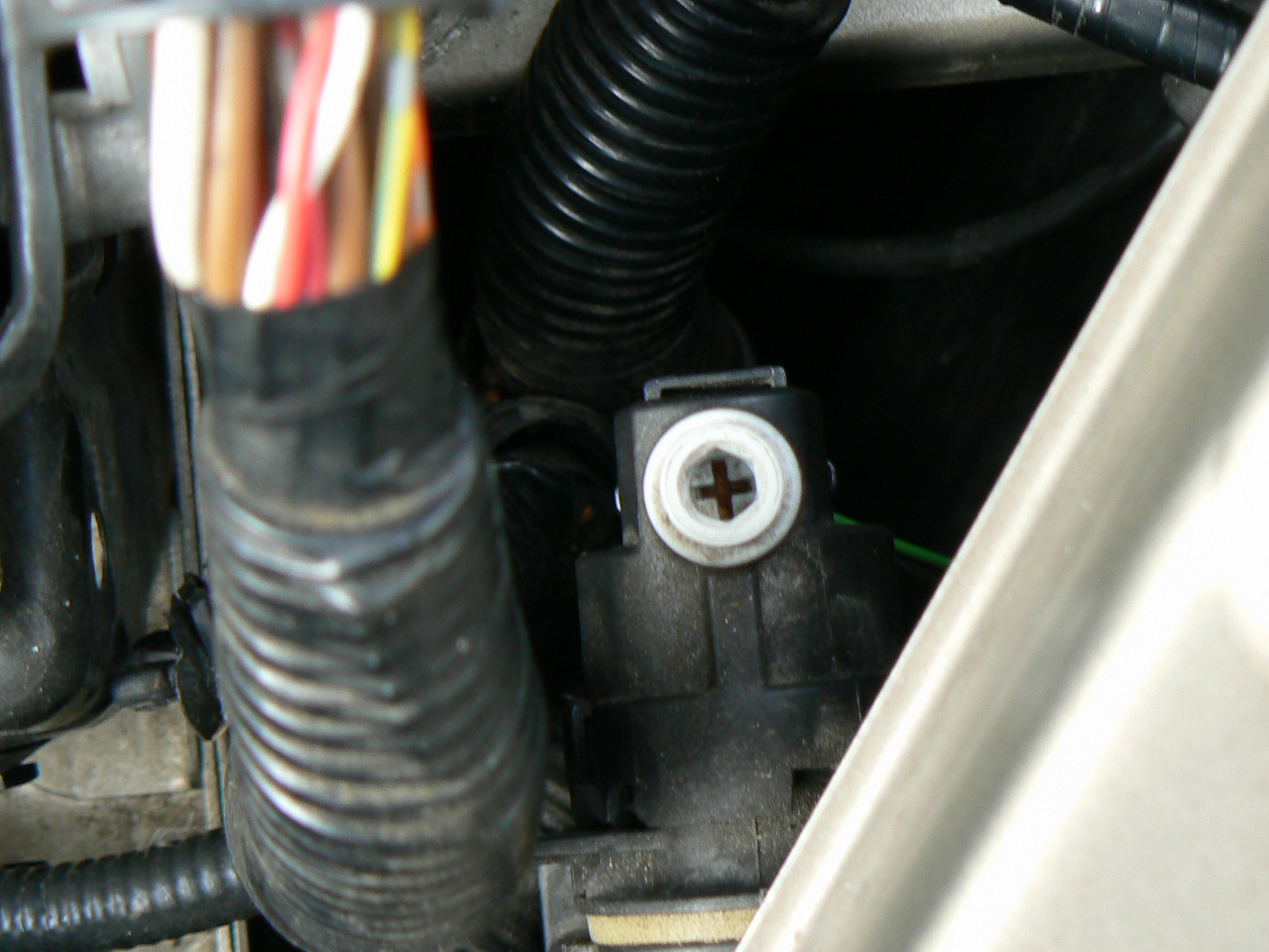

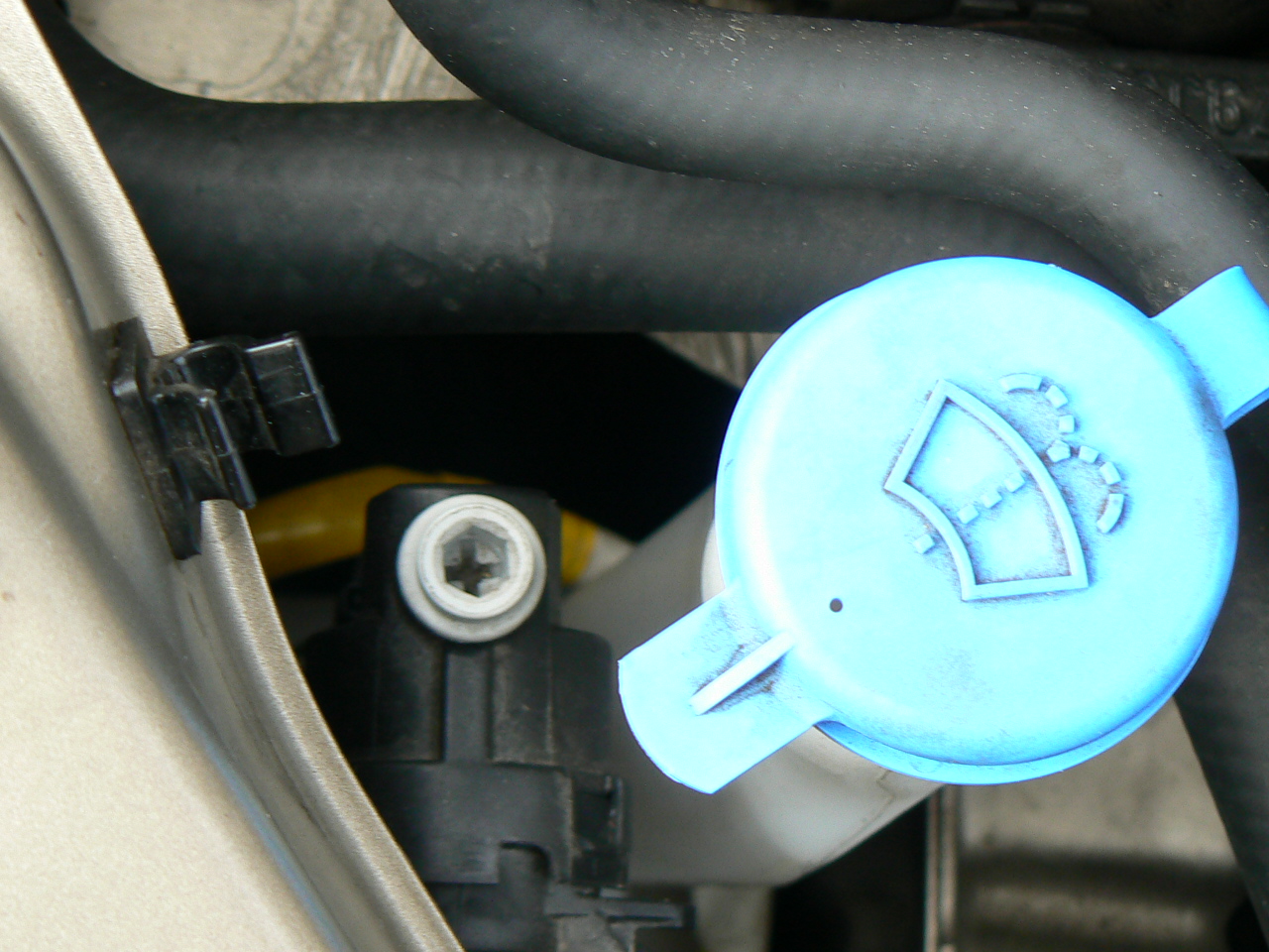

This is what I did. On the back of the headlamp unit is what I think is the motorised adjuster. At the top is a white hexagon shaped slot with a pozi fitting at the bottom of the hole. On my car this raised or lowered the beam depending which way it was turned. As for horizontal adjustment, I guess that the toothed wheel which can be seen through the casing below this would move the beams left or right. Haven't tried it as I don't need to. Perhaps another user can enlighten us here
Hi, this is what I'm talking about. When I did this job I used the horizontal lines on my garage door as a guide to equalize the beams from about 10mts away. I did try the knurled adjuster in pic 3 after marking with a felt tip but it didn't seem to do much so I returned it to where it was.
