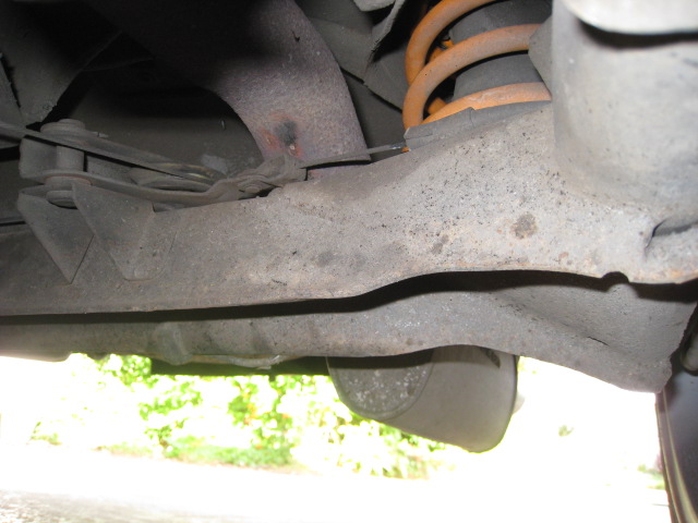

My hand brake does not work pads are fine it looks as if the the thing that routes the cable has been bent right over hitting the exhaust.
If anyone understands which bit im on about any chance of some pics on how it should be?
Thanks
It's usually a matter of loosening the clamp that joins the two sections of the exhaust (near the handbrake lever, halfway along the floor) and then twisting the rear section so as to gain more clearance over the rear beam and the swinging pulley bracket.
My pics won't be valid because the pipe is bigger than it should be :eek:
As you can see, there's been some contact. This doesn't worry me.

Thanks Alex that pic on the left is wat i need as the bracket on this one is all the way off
