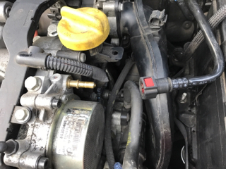

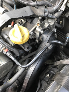

Remove the vacuum pipe by pressing the red detents and pulling away, then open the retaining pipe clip with a small flat bladed screw driver, tuck the pipe out of the way.

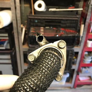

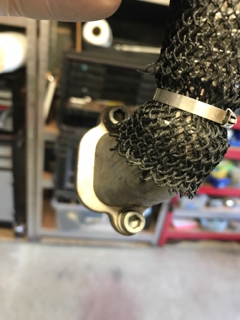

The EGR pipe to the left of the EGR valve is removed by undoing the upper joint which is 3 10mm bolts M6x12mm and the lower joint which is 2 Cap M5x23mm. the pipe will then remove with a twist required as there is a bent section that curves into the inlet manifold.

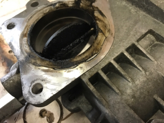

The EGR valve can then be separated on the workbench by undoing the x4 M4x16mm machine screws, this allows you to keep the electrical section of the valve well away from the cleaning of the valve.
The valve can be cleaned with EGR cleaner, rags nylon brushes etc and I also used.
Post cleaning the car felt like new, so smooth and no hesitation.
