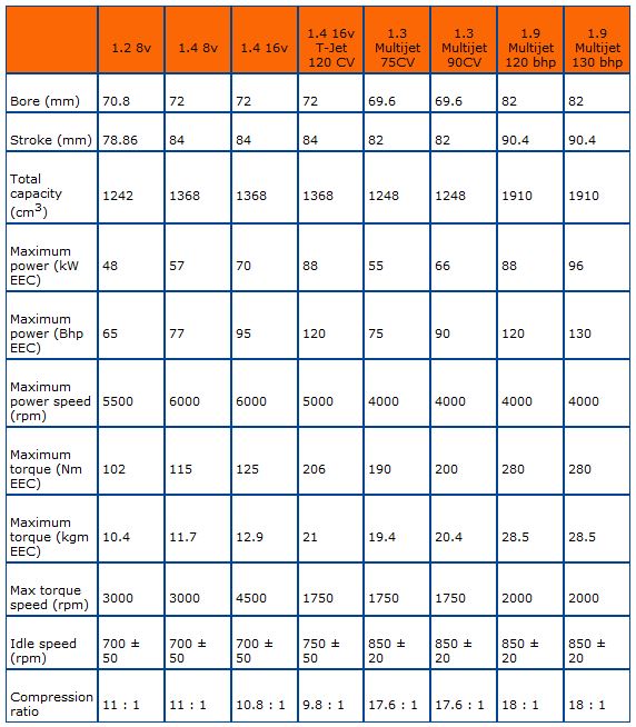

How do I identify a 1.4 8v cylinder head, vs a 1.2?? Will try to source a completely assembled head.
Best regards,
Ed.
