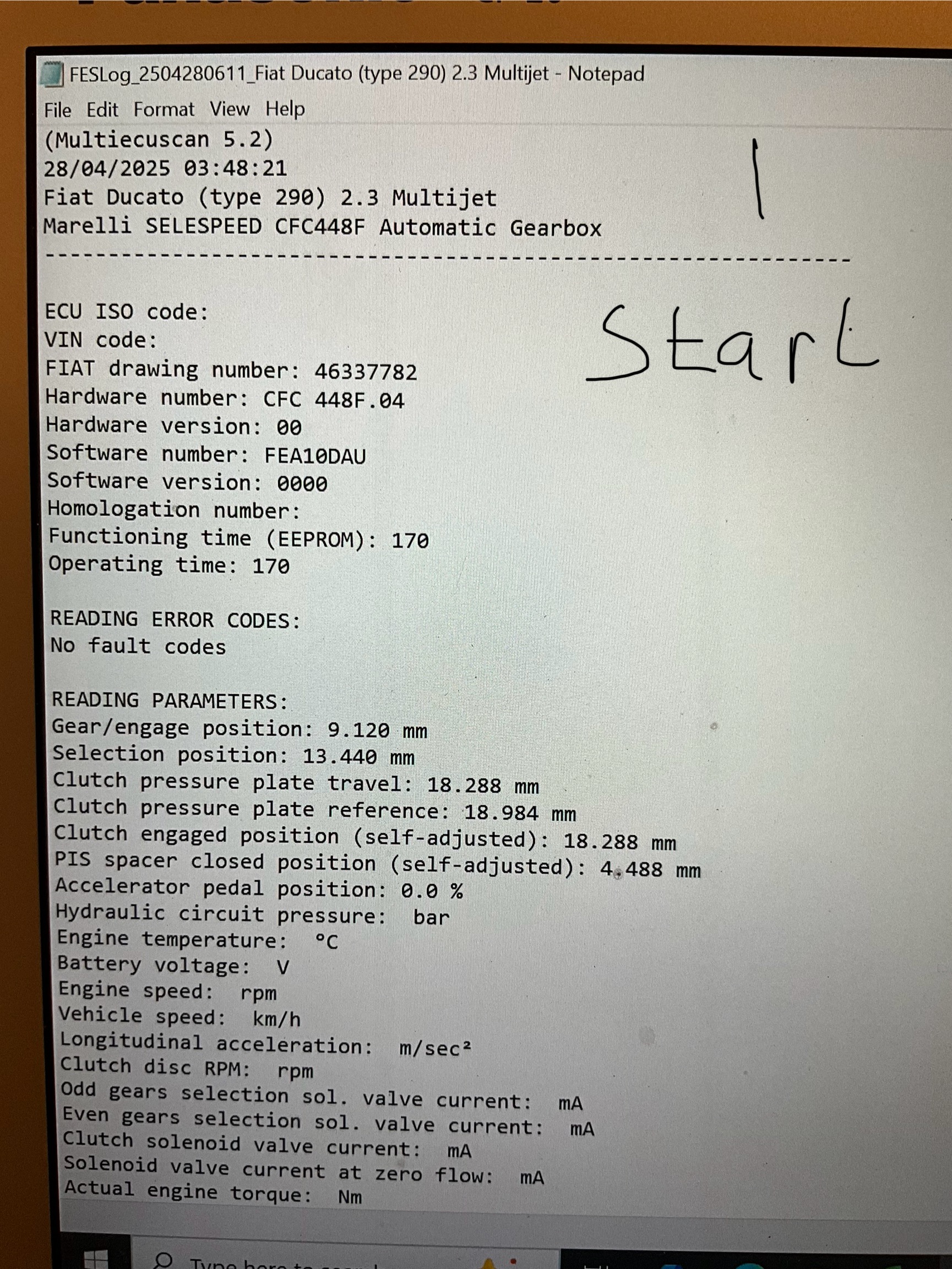

Speaking to the tech, there are 3 fault codes stored in the system.
Two of the three fault codes we believe are related to the immobiliser.
The third to related to the Selespeed system.

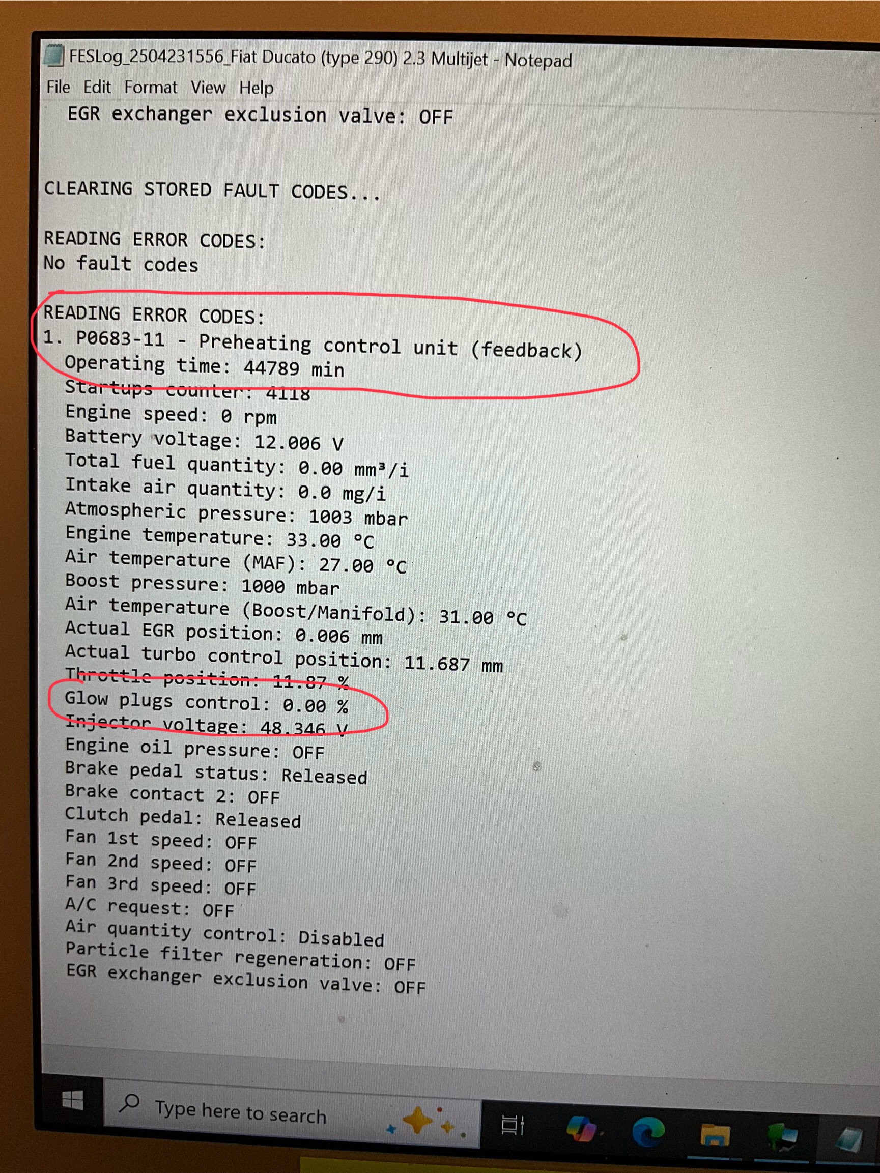

Had Ghost removed reluctantly by the technician who tried to say Fiat probably never put it in service mode ( I did!) and then new error Glowplugs appeared whilst he was taping it back up , he installed his diagnostic and said it was clear despite flashing lights on dash.

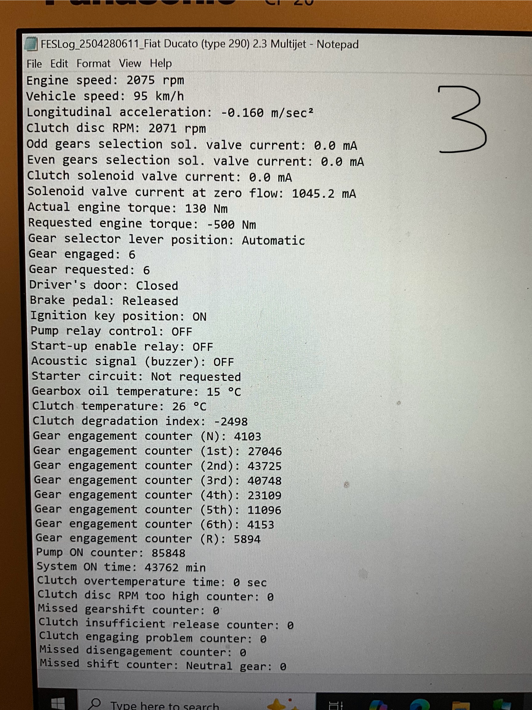

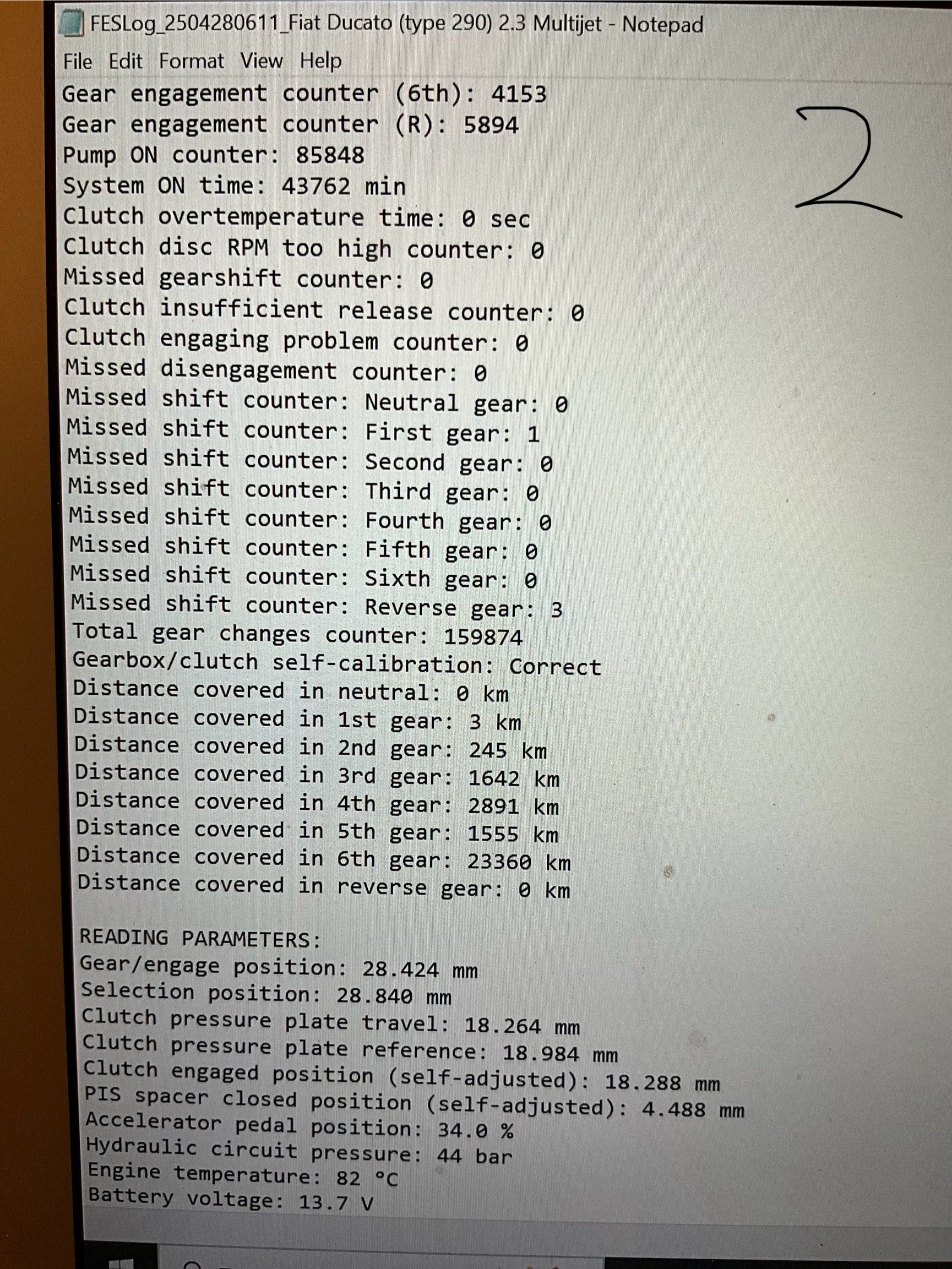

Fast forward a further 500 miles later after kindly borrowing a MES I run the diagnostic and finally had the courage to drive in Automatic mode and only glow plug error appears and I couldn’t clear. Automatic transmission drove normally I had the MES on for a week drove 300 miles testing
