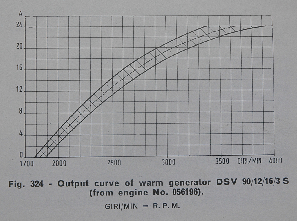

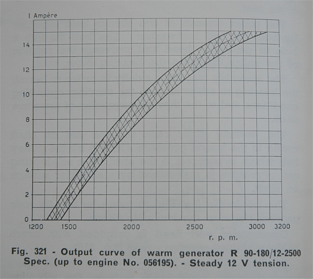

I've attached a couple of output graphs taken from the shop manual. The earlier generators should put out about 8A at 2000rpm.
Resistances are measured at 20degC (68degF) and are 0.145 (+/- 0.01) ohms for the armature and 8 (+0.1, -0.3) ohms for the field winding. This applies to both the 180W and the later 230W generators.
