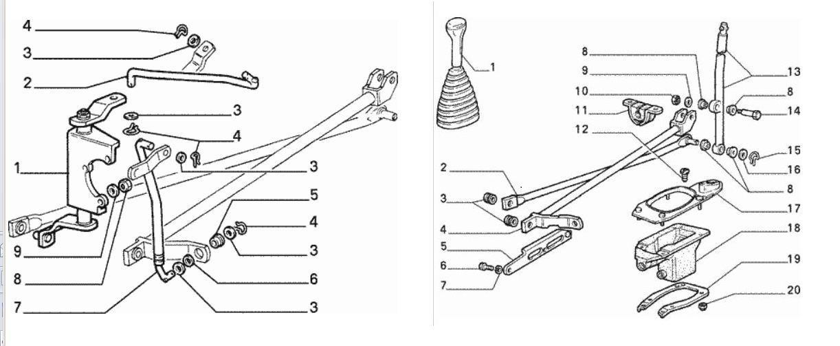

I've decided to sort out the "stirring a pot of porridge" gear lever and buy some new gear bushes. And then I remember why I haven't before because there are a few different kits and I can't decide what's right for a 1991 4x4.

both sets are ok and needed for full linkage regeneration, one set is for the "front" side of the mechanism, small rods/selectors, near the gearbox, other for the "rear"side near the gearstck, plus front of long rods.
the ricambio sets seem to supply 2 versions of the bushes circled in the larger circle in your set no.2 drawing, one with roller bearings, one with bushes, neither of them show any bushes for the rods?

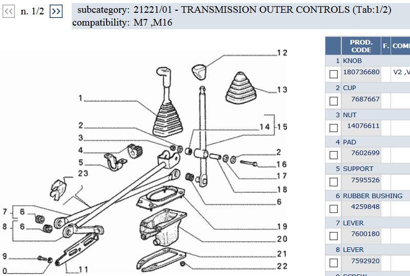

I'm not sure where the roller bearing goes, definitely not at the bottom and top of the vertical shaft as on photo above.
There are two 'plastic' bushes with flange and diagonal cut.
Personally I would try to avoid the 'orange' ball joint clinch bushes as they are crap as hell.
Fiat does them in black.
Roller bearing isn't used on UK 4x4 - attachment 1.
They are shown as no. 14 on the attachment 2 - M7, M16 - which refers to 2wd 1000 SPI USA - Bosh/Weber.
