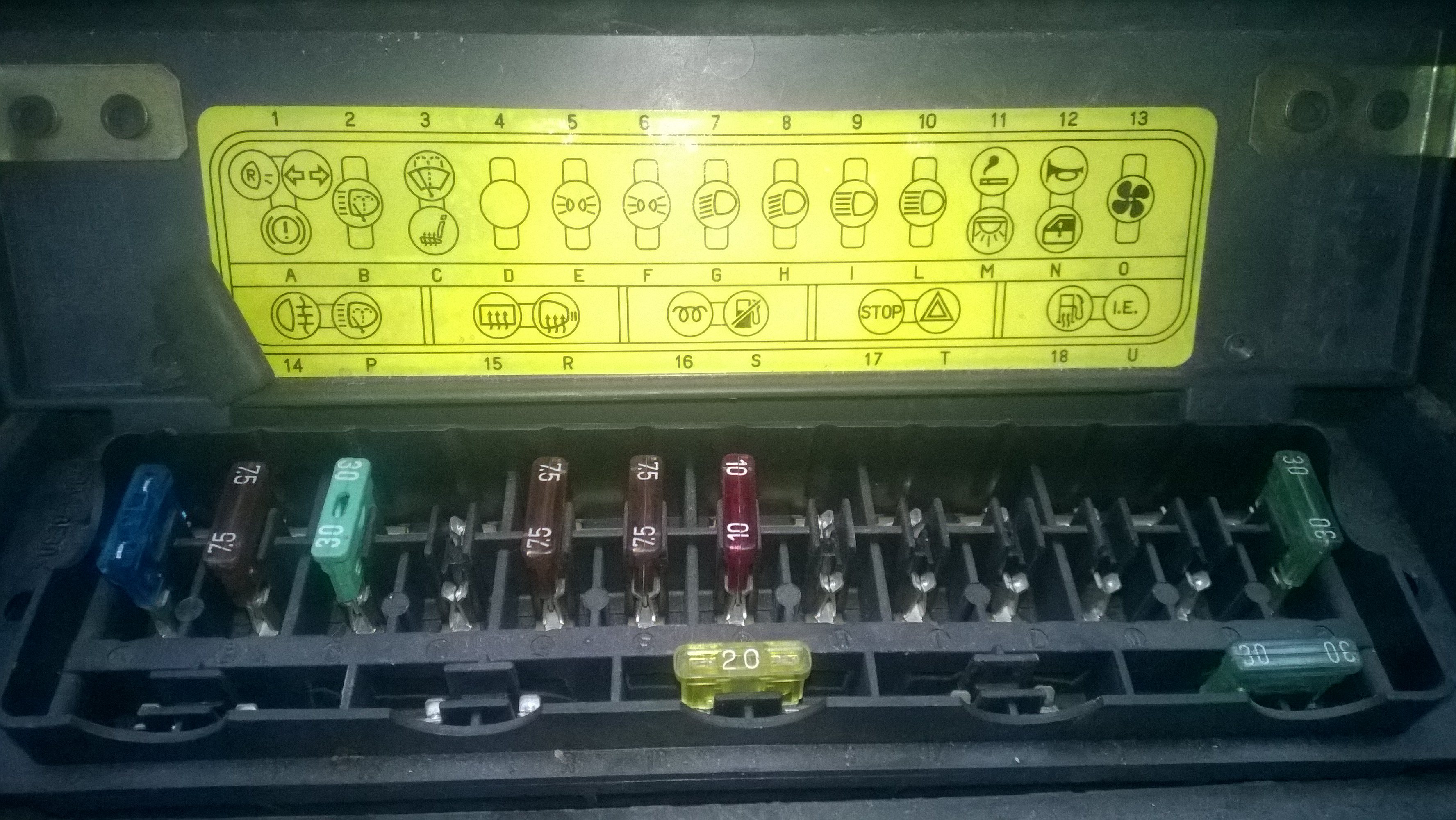

good morning all, new member here, recently bought a ducato maxi 2.8 diesel yr 2000 (X-reg) and there are a number of fuses missing from the fuse box in the glove box, looked on the lid and there are no clues as in 5a 10a 20a 30a as to what fuses goes in where, with the way my luck has been going of late, i put a fuse in the wrong socket and the van is going to go nuclear and sprout wings can somone help

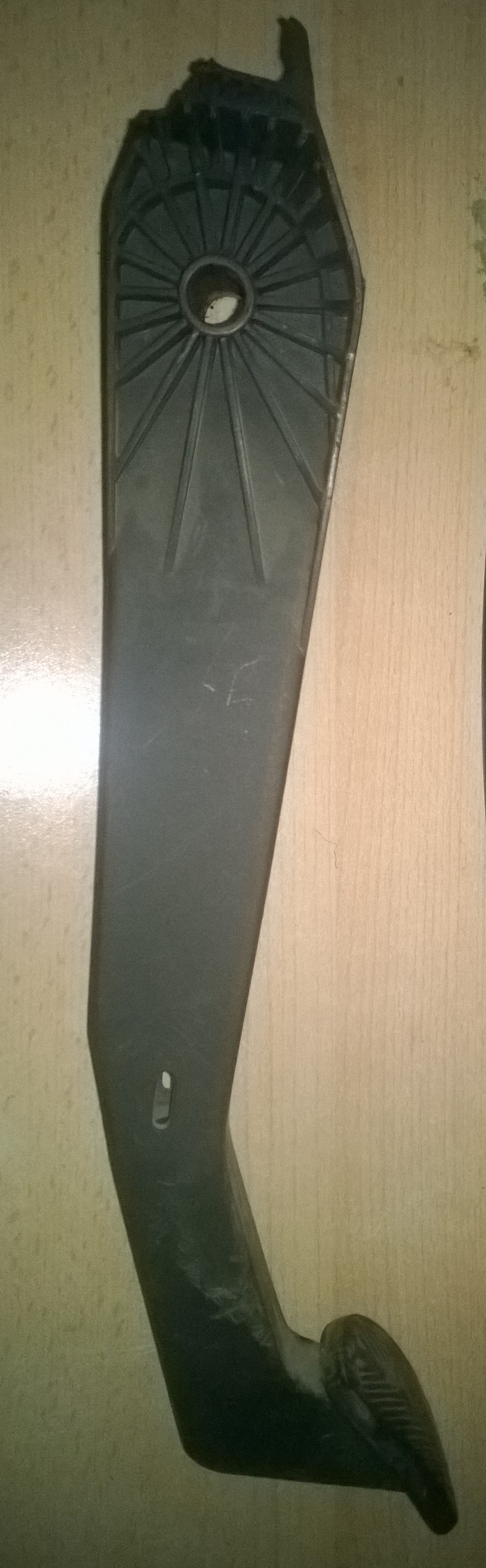

additionally last night, coming back from picking daughter up from rainbows and the plastic it on the clutch pedal decided to snap coming off the roundabout, i have found numerous clutch pedals but which is the right one or are the generic in fitting?
It is quite normal for there to be positions not used on that model of vehicle. I would not worry about it as long as everything works.
Get hold of an owners manual for your vehicle and you should know what every fuse is for.
problem 1 uploading a photo of the fuse box in the van, as you can see what fuses are missing
problem 2
how the hell do i get the clutch pedal out, looking at both end, it appears to be threaded bar with with these clips on each end
what i have discovered is not working through lack of fuses
radio - not helpfull as it has a usb for phone charging
cigar lighter (not helpful) for charging my phone,
the light for the handbrake is on even when the handbrake is off
brake lights -found that one out when reversing into tesco's parking space (rear lights, just not brake lights)
full beams (dipped works)
horn
gonna need some work
You need someone with a van of the same year to post a copy of their wiring diagram. That will give you the correct fuse ratings for what is missing.
Mine is totally different to yours otherwise I could have done it.
clips off, there has to be an easier way than putting pressure on the bar while lifting and pushing the clutch pedal
ahh nuts, when was the clutch pedal modified?
took the pedal off and found there has been a design change from the one i bought
left one is the one i took off
right one is the one i bought
