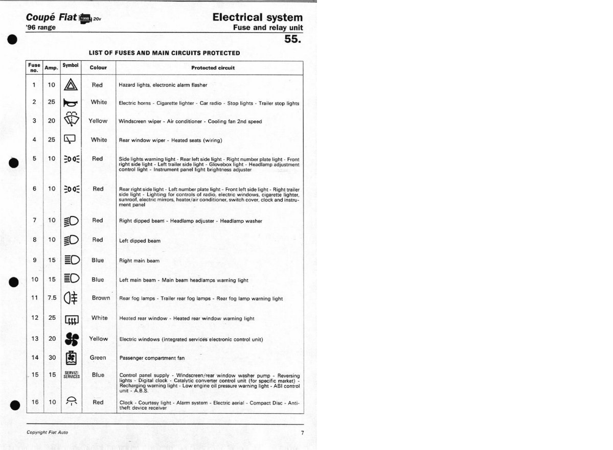

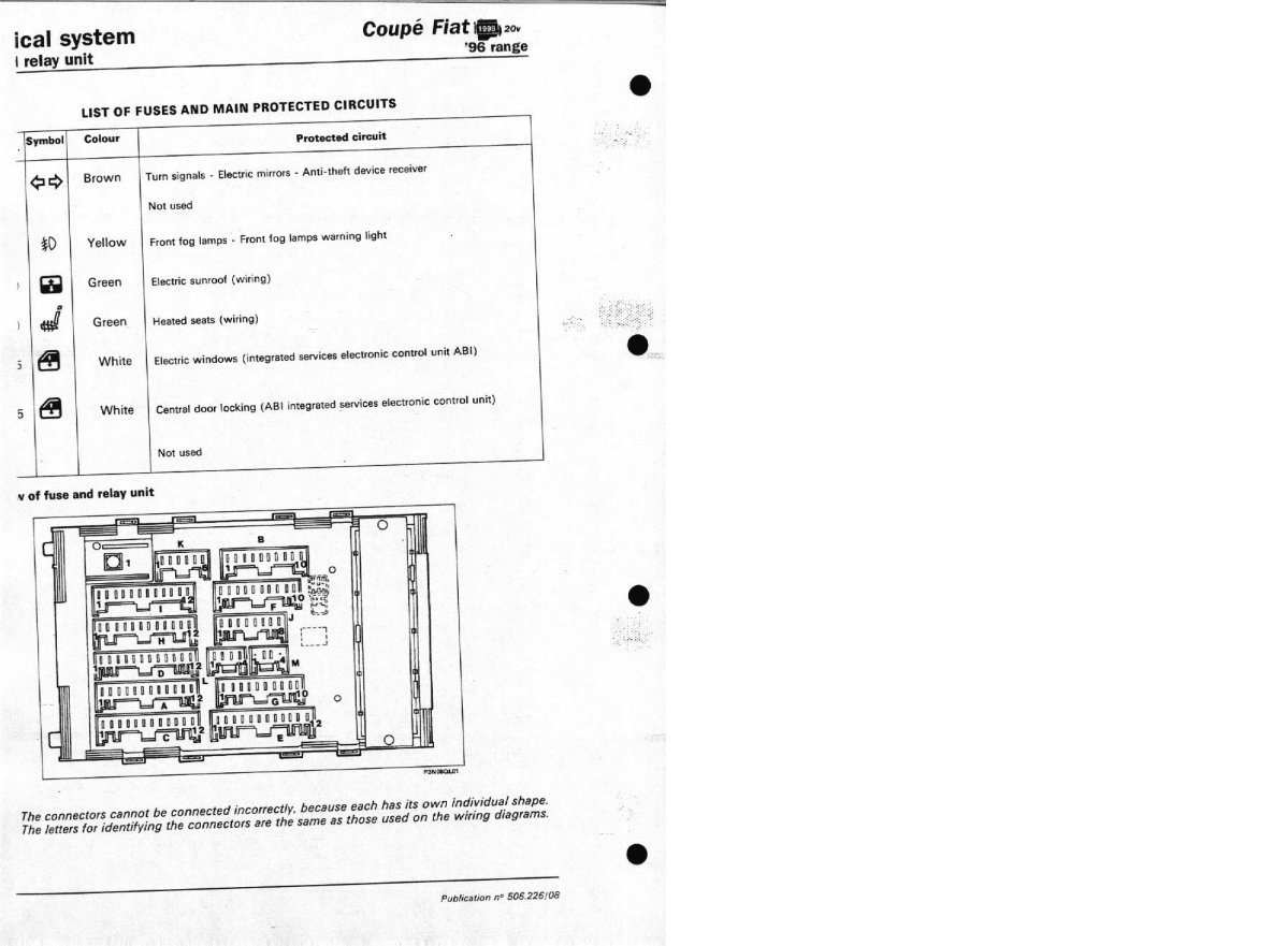

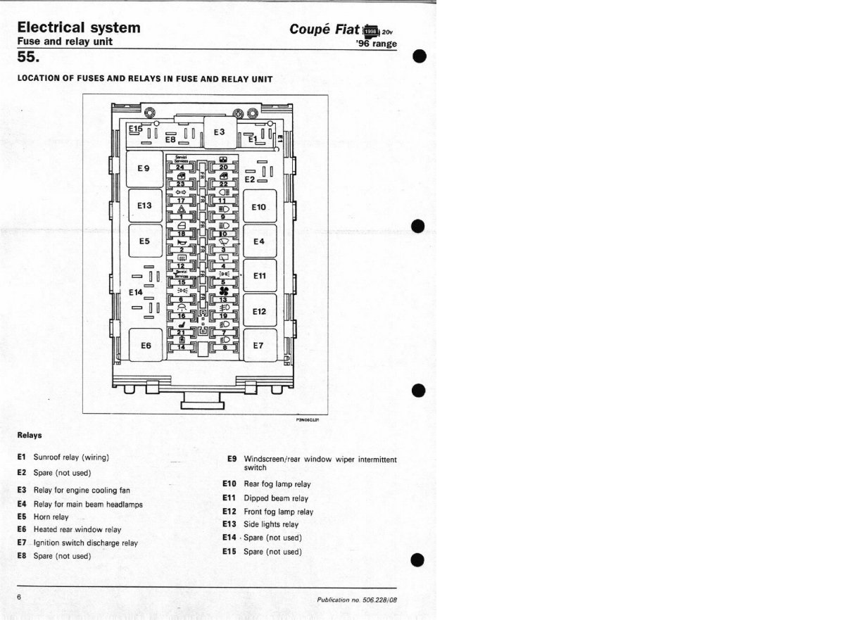

Does anyone have the diagram for the fuse boxe(s) for a 1996 Coupe? Specifically the one under the dash. I blew the radio fuse and replaced it with another and am trying to figure out which one I stole so I can replace that one.
I tried searching online and the forums and couldn't find one. Thanks!
Hi, Welcome to the FF.
This is the only fuse box diagram I have.
