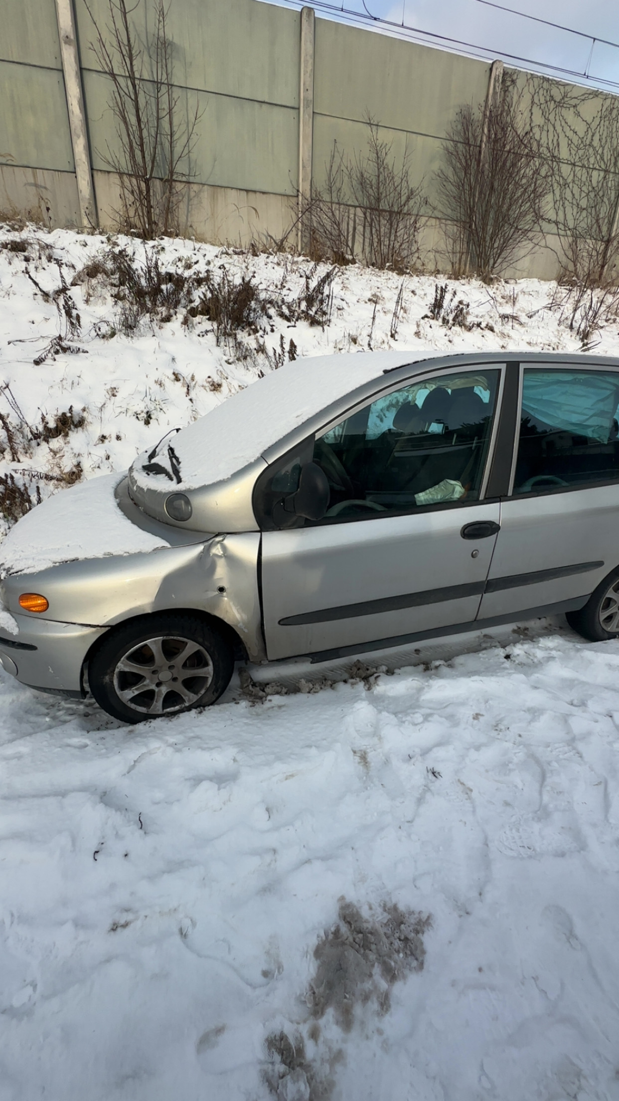

Hello, i just had crash in my diesel 2001 fiat multipla 1.9jtd 85kW, i didnt hit the engine, but the car wont start. I think it could be the fuel switch, but i dont know whete it is. Can someone help me find it? If someone send a photo it would be absolutely perfect. Thanks

Looks like you got away lightly. Hopefully you can get it back on the road quickly. Think I'd be looking under the seat for the reset button but no doubt the people here will know for certain. It may tell you in the handbook if you have one 🤔👍🇮🇪

On my Fiat Panda the handbook says that it's under the driver's seat. But in Italy the driver sits on the left. So in this countryit's actually under the passenger seat.
Multipla-not under seat
Photo in post 3 is of my right hand drive multipla(yes I found the switch where pointing)-the drivers hand book states it is on left but suspect that is for left hand drive
You cant see the switch but you can feel the switch under top edge of plastic panel . Press down on round rubber part to reset
