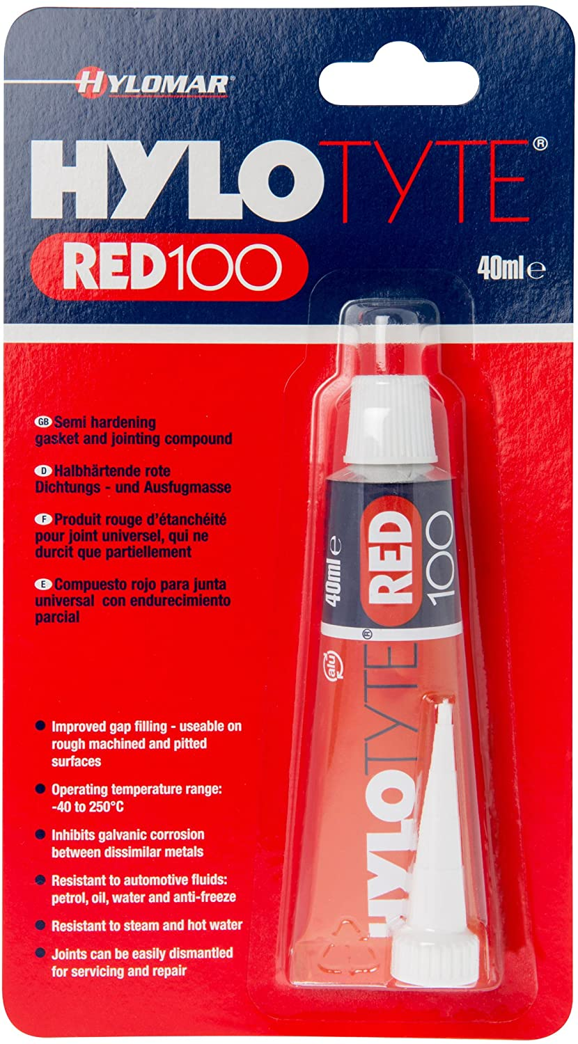

Fuel will get through any tiny leak as it is so thin.
If the hose isn't split it may just need sealing better.
I had similar when I changed my main filler pipe.
I used Hylomar Red on the connection before pushing the pipe on and clamping it.
I did, but there is a rubber hose connected to it, its just leaking
ok
