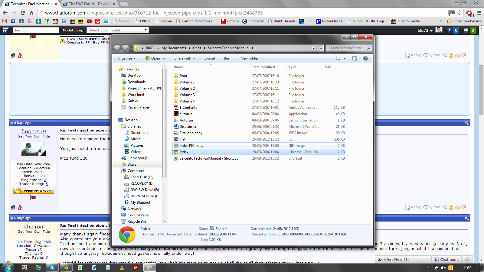

just to check you are doing this right....
download all parts, place them in the same folder on your computer. Only when you have all parts in the same place uncompress them with whatever program you using (again, leave all the resulting files in same folder) you should only need to uncompress any one of them and it will unzip all the files from all 3 at the same time because of how the files were made.
you should get the files shown in the pic attached in the folder you have unzipped them to. If you open the file 'index.html' it will open in your default internet browser and you can just browse through it from there like your are using a website.
Oh and fingers, its in 3 parts as there is a limit to how big the files can be - hence the cinq manual you sent me the other day is also split into a few files ;)
