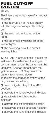

Hi All, got this "Fuel cut-off unavailable" on the dash and car won't start. Is there a way to trigger this switch manually or electronically using MES? Would appreciate your help. I am trying to find the physical location of the switch struggling to find it in the interweb. Would appreciate any help. Thanks.

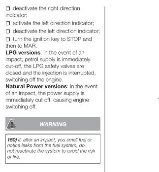

From handbook how to reset:

Thanks KPat for your post. Great reference for the future. I tried the procedure but although it did not work for me, I had that "eureka" moment when I noticed my battery was not discharging at MAR position and figured out the earth cable is about to detach itself with a few strands of wire left....then went to Halfords and grabbed that 9inch earth cable for £2.59. Car is "purring" again! :) Charge to experience and hope this helps other Panda owners. Cheers!
