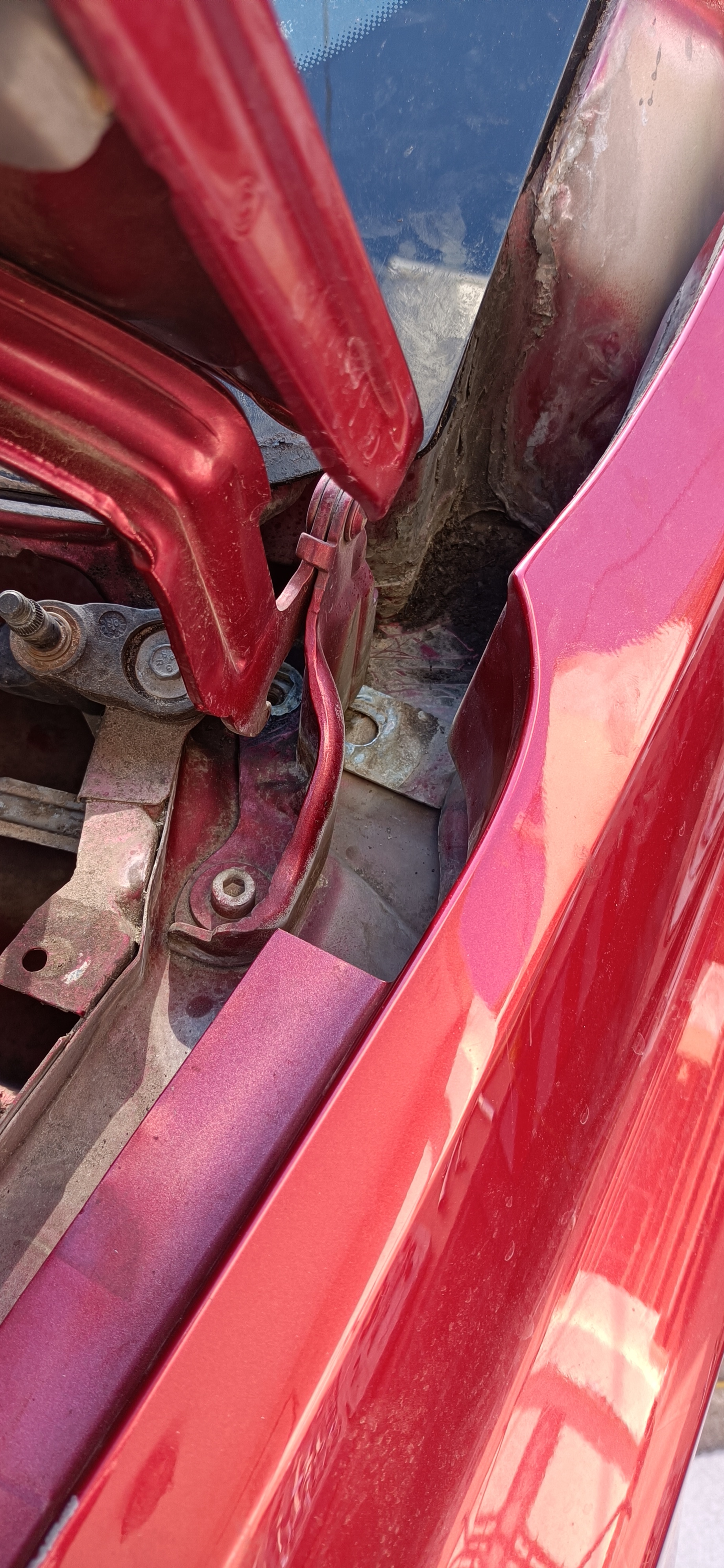

The screw I found last was the one holding the car's bonnet.
