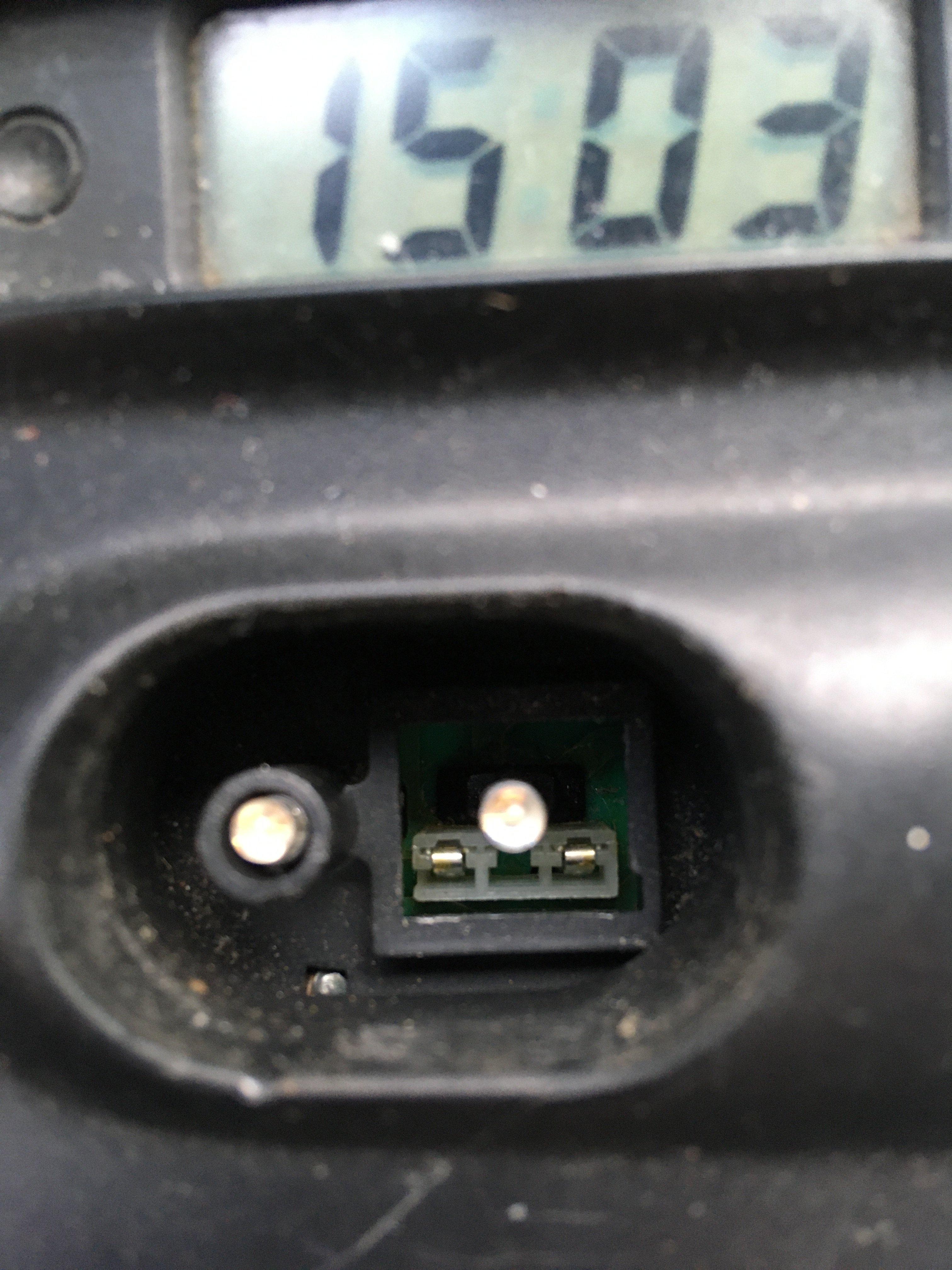

Thanks Chris! There is a blank where the switch should be. And surprising, under that are 2 signal lights and a socket for the switch ( see photos). Just have to find one ;)

You're welcome. Seems odd if you have the lights but not the switch but life is full of mysteries.

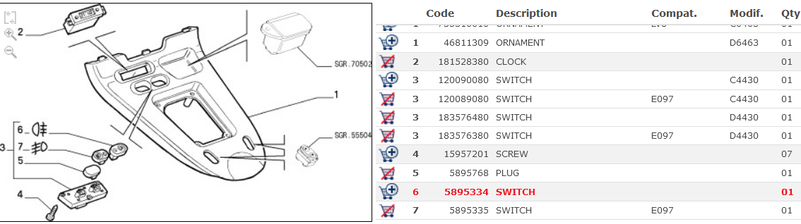

Henk at Barchetta Parts does have the combined switch panel in stock:
If you go hunting for one then the part number is 5895335
Thanks again! I'd found the drawing, but not the part numbers. This is a Dutch car, and for our APK (MOT or State Inspection) if the lights do not work properly they must be removed or disabled. I'll see if I can find the switch as a separate component. I have seen them as the complete set.
