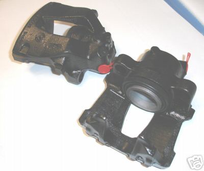

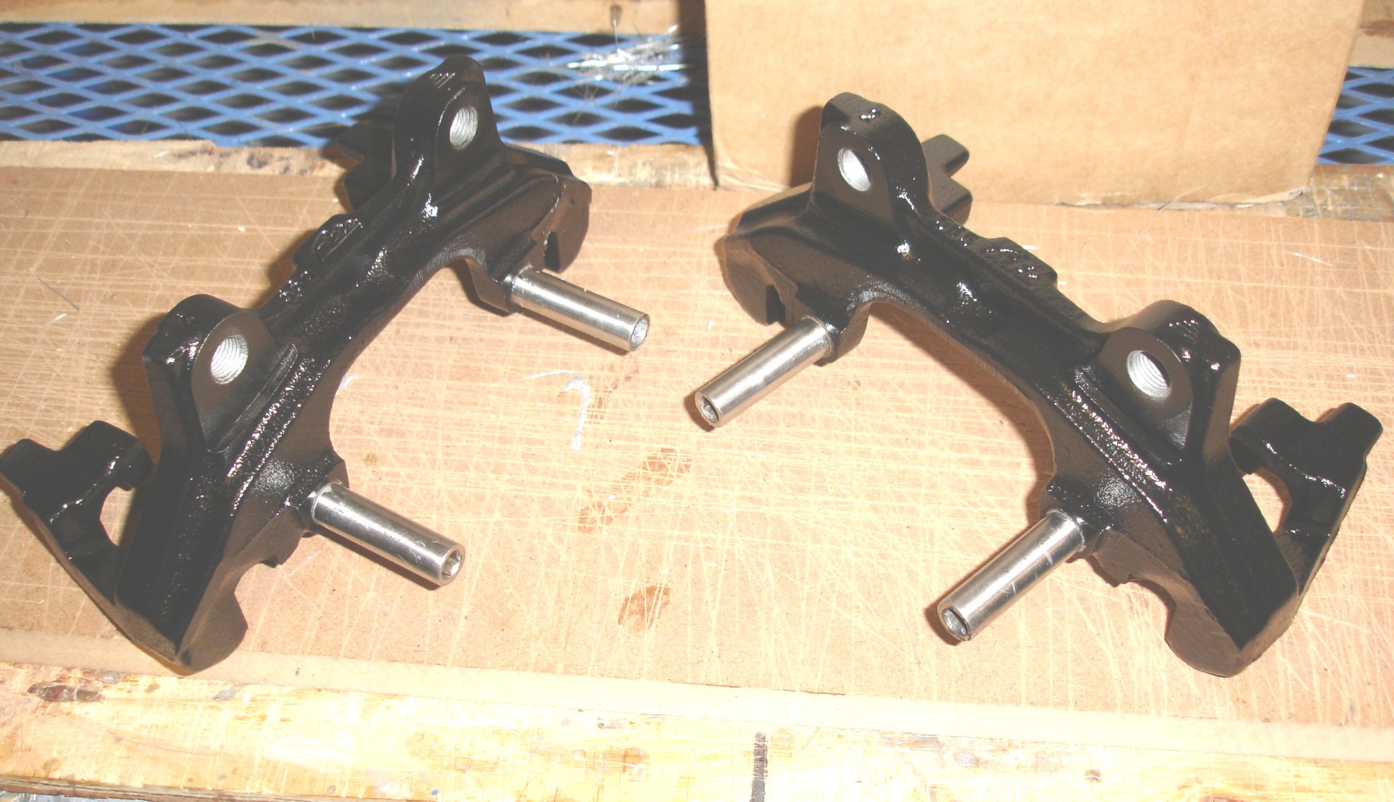

If its the same design as the ones I had, looks like its missing a spring and some rubber slide covers. Rich can confirm if the coupe 16vt have/need the spring.

Mine look just like hell cats, yes they have and need the spring, but there were 2 types fitted to the 16vt, not sure of the difference though.

Here you go. I have about 1 day left to find some calipers

thats them, but you must get the spring too, sure they would be available seperate, but what pain to have to go digging for them.
