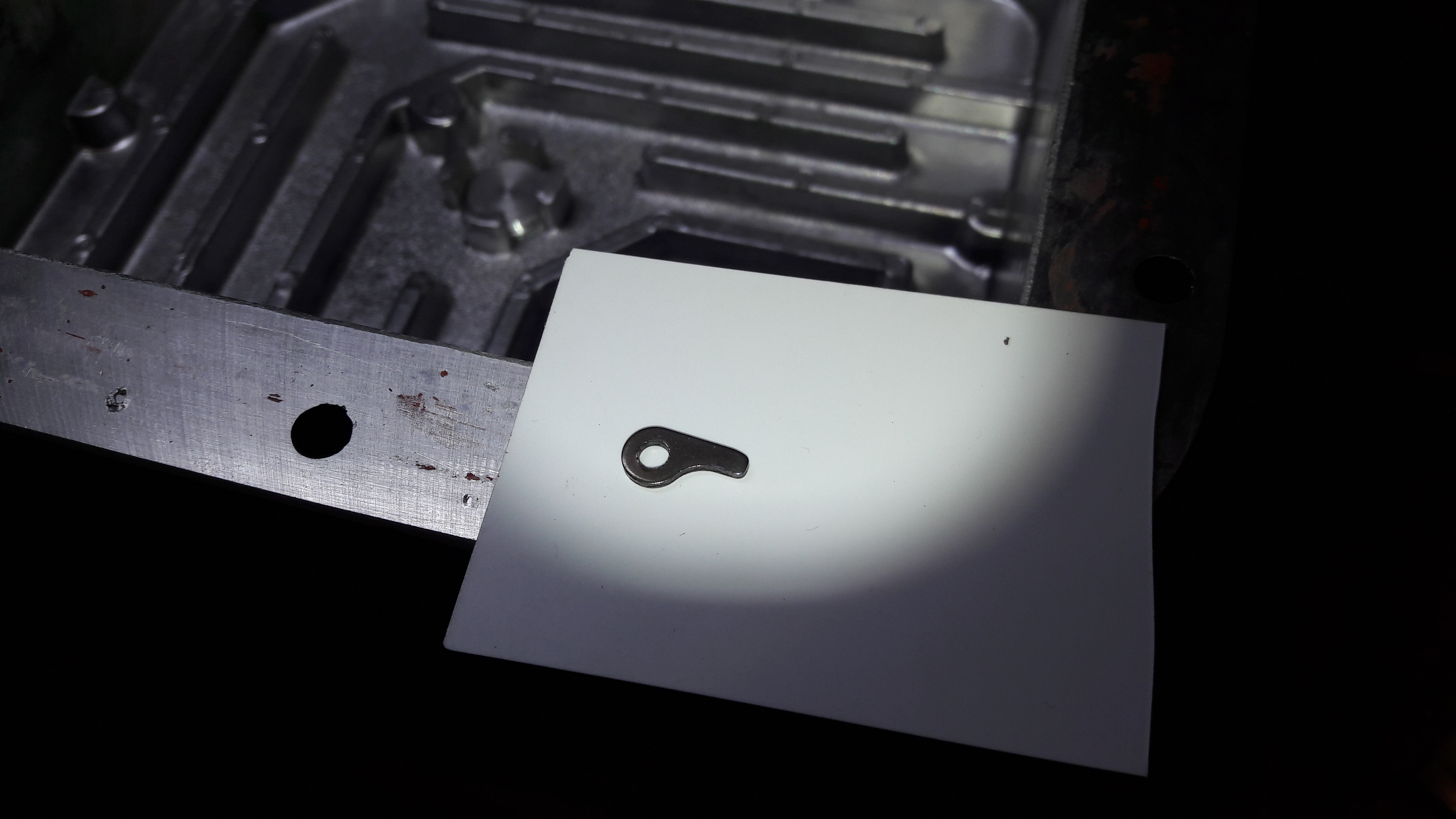

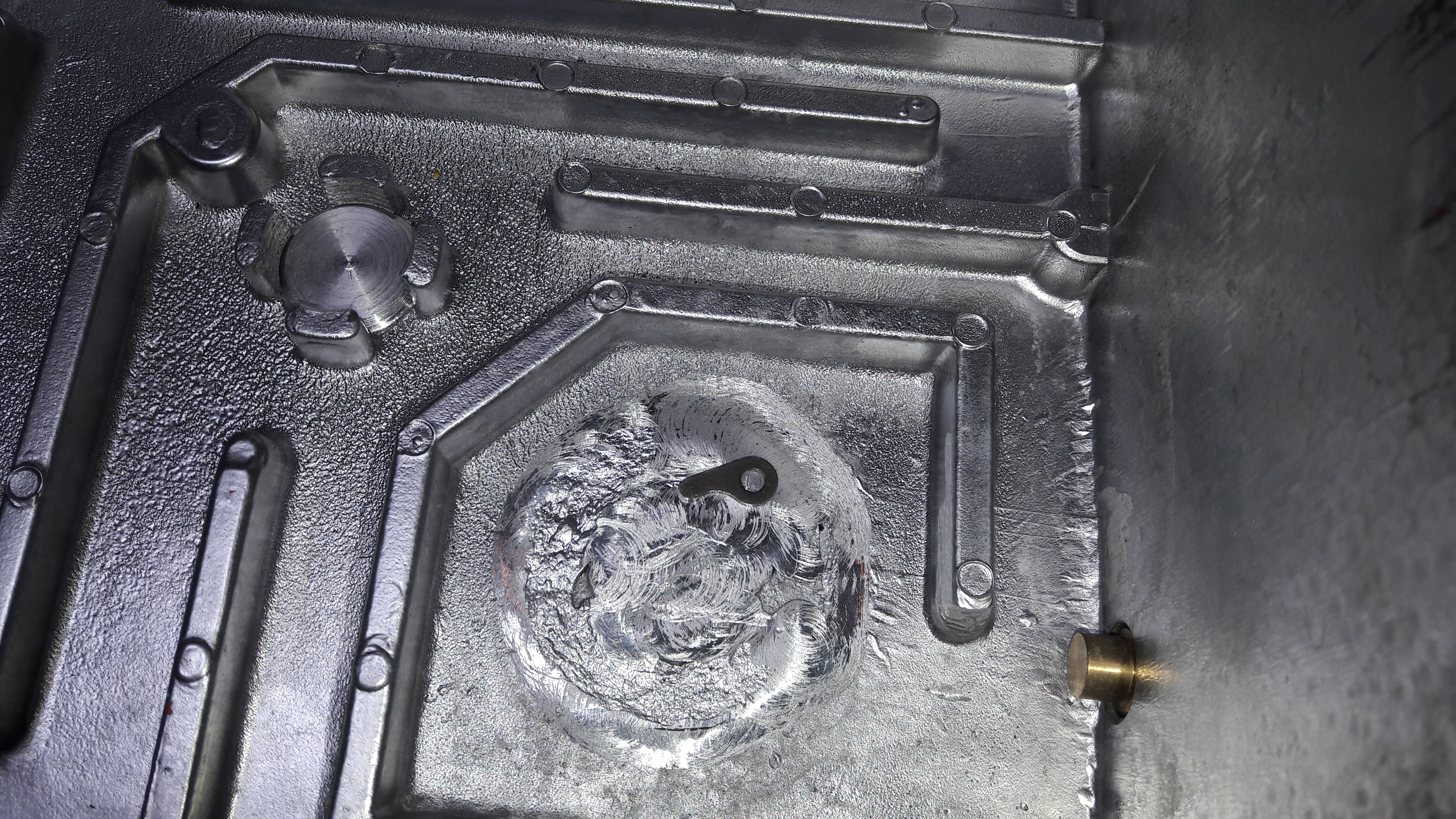

Ok this comes from timing chain, i don't know why the chain has those little (whatever you call them) installed in chain links and i am not sure if they come from my chain or it is just a left over from previous chain although i don't think so. There is a small hole next to the oil pump from where i can inspect the chain and see if it is missing from this one. In a case it is missing what do you think i should do? Shall i open the chain cover and replace the chain?:bang:

Thomas, check the chain - it's not a long job and if you have a broken link it may fail completely at speed and wreck the cam sprocket, oil pump and the cam. :eek::eek::eek: It's not worth the chance, I would open it up and look. (y)(y)
Ian.
Completely agree with Ian---check the timing-chain. If the link HAS come off the chain currently, change it immediately, but you MUST change it----the ramifications of the chain breaking are expensive!.
What I meant to say was:---if the link has come of the chain currently fitted, CHECK it immediately, but you MUST change it.
Sorry about that, but my brain cell and my fingers were not working at the same speed---but then I do have 10 fingers and only 1 brain cell!

Those links are described as chain tensioners but I don't know how they work,?
.... centrifugal force maybe???
Yep - the little levers are thrown outward during normal operation and act as dynamic tensioners. Most engines have either a mechanical spring loaded tensioner or a hydraulic one and their chains do not need these little levers.
I've got to echo everyone else - if you've found a bit of the chain in the sump, the whole chain needs to be changed as I think that there is a fair bit of valve overlap (interference) in these engines and a snapped chain will ruin your engine completely.
