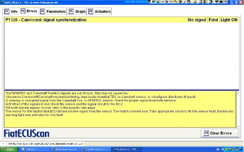

Next time I switched on I got the MIL. Used FiatEcuScan which reported error P1320 Cam/crank signal synchronization. See below. Obviously I had to disturb the cam sensor to remove the pump but am not aware of damaging anything. Why the stored error? Is there still a problem?
When I next switched on the MIL was off but the error is still stored. Is there a test I can run in FiatEcuScan? Any help appreciated

Same error.
Cleared the error and it was back straight away before attempting to start. It didn't do that before swapping the sensor. It doesn't start at all so the ecu is not allowing the injectors to function.

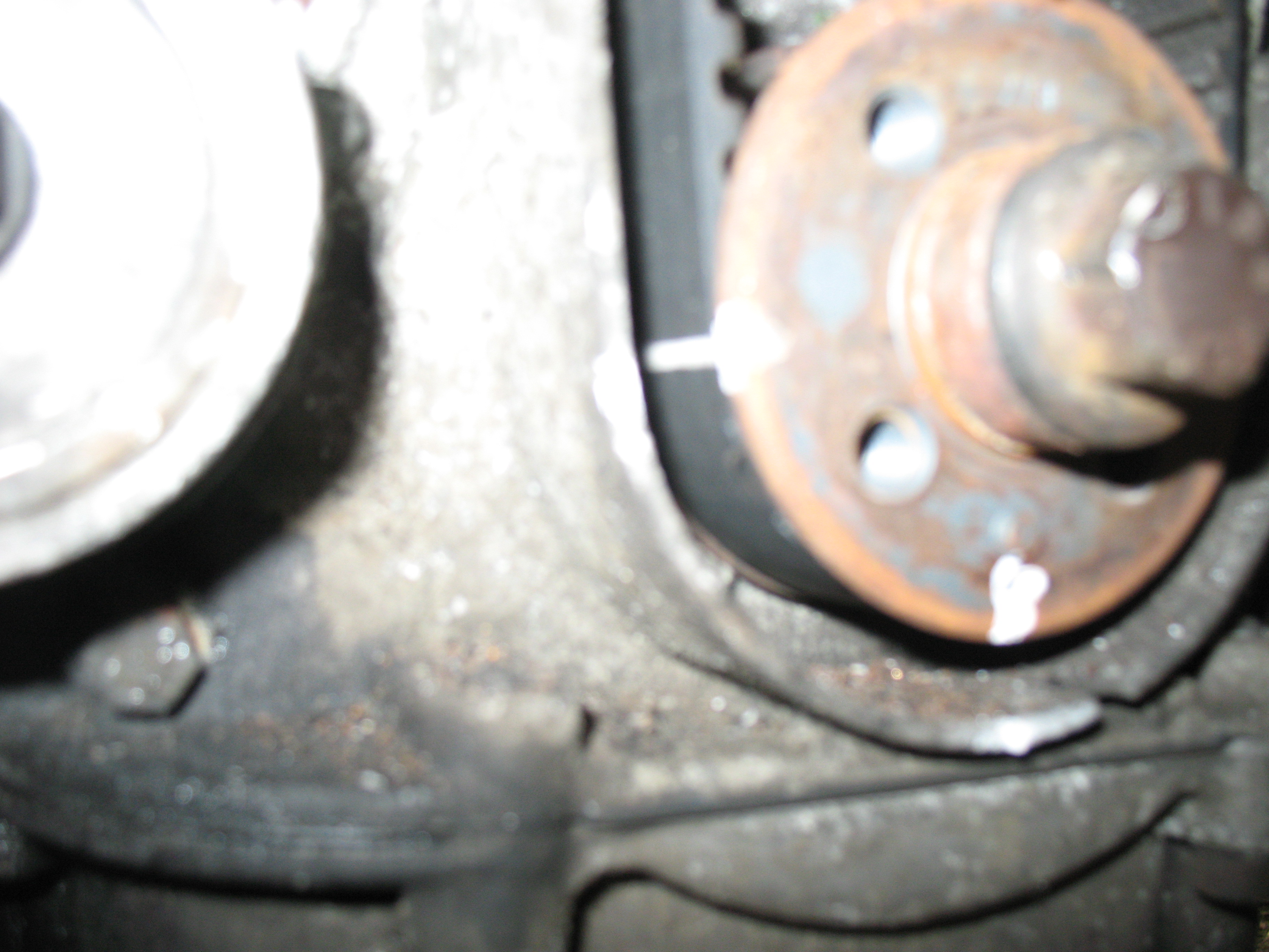

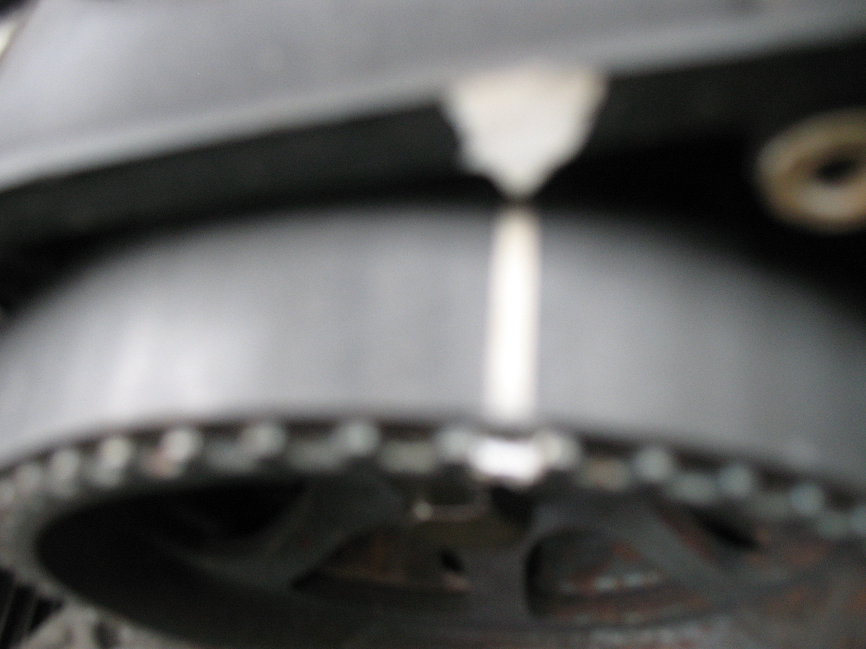

Could someone check my timing. I have attached pics showing the lines on the belt and the current Fatal P1320 error.
